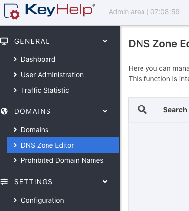

Re: Custom Name Servers
Take a look in the admin area, there you will find the DNS Zone Editor in the DOMAINS section.
