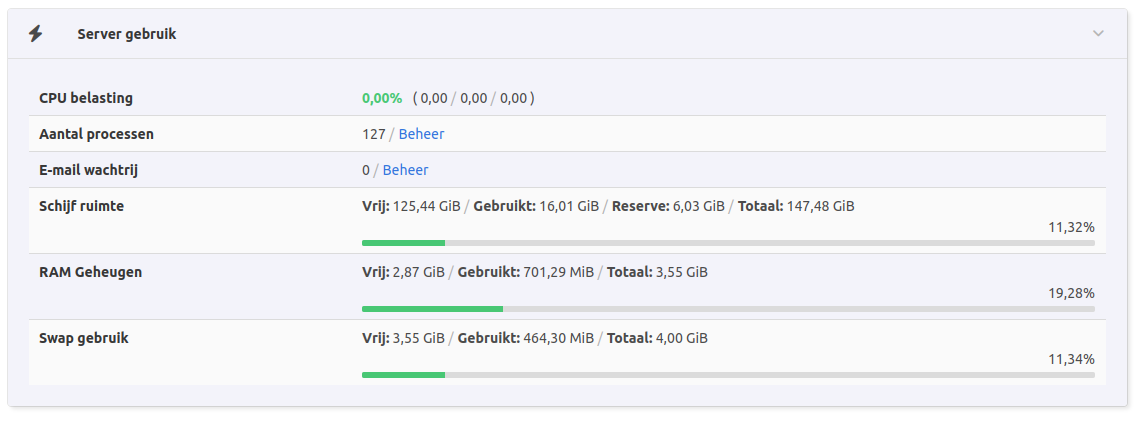

Post by BasHeijermans »
It seems to work....finally....the server is really fast.
And the numbers show it's not eating memory for candy anymore.
Alex, you may want to introduce a setting, how much it should consume.
Greetings Bas.

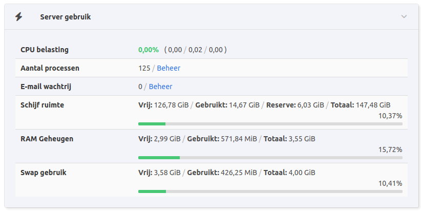

On your server it started swapping, so I did the things above and turned off email-server Antivirus.
This is what happened :D
Memory to spare and no more swapping.
Most users run their own mail-AV software on Windows anyway, so scanning on the server is not really needed for me.
I advise to set these parameters I listed above and turn of AV-email on Low-memory systems as it eats a whopping 1.3G :o
Greetings Bas.

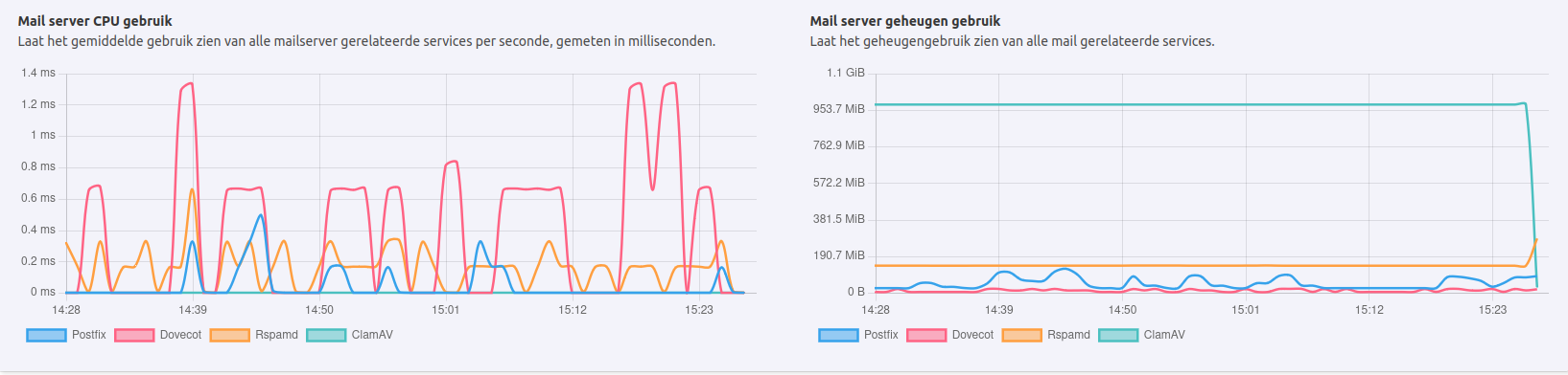

Little bit longer and it works.....
The server is quiet, fast en not doing much, as it should as we don't use it for many things but a few friends and some email.
The biggest task is NTP-pool-server :D
Greetings Bas.

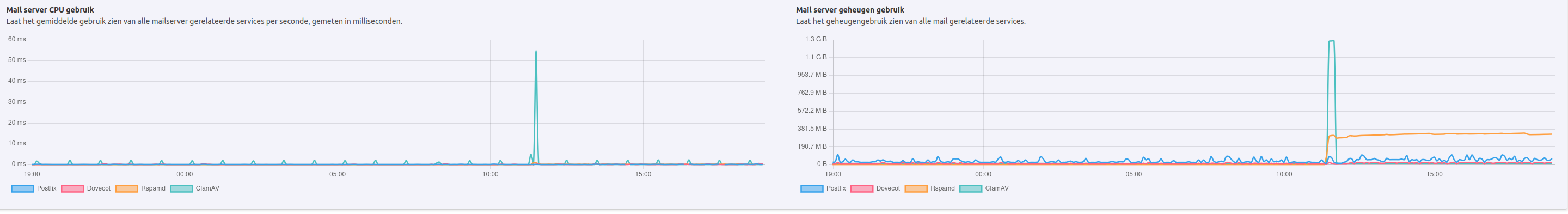

It's running for more then a week now....still humming along and fast as can be.
So yes, the settings I suggest are good.
This server does runs at KeyWeb, best move I did ever.....they do know how to do VPS and do it well.
Works:
rdbcompression no
rdbchecksum no
maxmemory 536870912
maxmemory-policy volatile-lru
Antivirus for Email should be disabled by default on all systems in my opinion, let an admin decide if he wants the 'extra' protection as it does eat memory.
AV also eats CPU-cycles making a server very slow.
As for the maxmemory, maybe a good idea to make it selectable, as more memory means more 'tokes' stored and better spam-protection.
However, a large database eats CPU and memory, not very desired either.
Greetings Bas.
