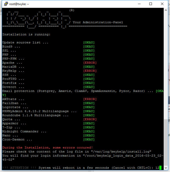

Allerdings bekomme ich während der Installation einige Errors, und zwar bei "Apache", "KeyHelp", "AWStats" und "Quota":
Nach dem Neustart, wird bei Aufruf der IP des Servers die Apache Default Page angezeigt.
Hier die Errors aus dem Log:
[Apache]
exec | apt-get install -y apache2-mpm-worker libapache2-mod-fastcgi apache2-suexec-custom
Reading package lists...
Building dependency tree...
Reading state information...
Package libapache2-mod-fastcgi is not available, but is referred to by another package.
This may mean that the package is missing, has been obsoleted, or
is only available from another source
E: Package 'libapache2-mod-fastcgi' has no installation candidate
!!! ERROR DETECTED !!!
exec | chmod 0750 /home/keyhelp
exec | chown keyhelp:keyhelp /home/keyhelp/www/cgi-bin
chown: cannot access '/home/keyhelp/www/cgi-bin': No such file or directory
exec | apt-get install -y awstats
awstats is already the newest version.
0 upgraded, 0 newly installed, 0 to remove and 122 not upgraded.
exec | rm -f /etc/cron.d/awstats
exec | mv /etc/awstats/awstats.conf /etc/awstats/awstats.conf.disabled
mv: cannot stat '/etc/awstats/awstats.conf': No such file or directory
exec | apt-get install -y quota quotatool
quota is already the newest version.
quotatool is already the newest version.
exec | service quota stop
* Turning off quotas...
...done.
exec | cp /etc/fstab /etc/fstab-backup
exec | echo "/vz/private/176 / simfs rw,relatime,usrquota,grpquota 0 1
proc /proc proc defaults 0 0
none /dev/pts devpts rw,gid=5,mode=620 0 0
none /run/shm tmpfs defaults 0 0" > "/etc/fstab"
exec | mount -o remount /
mount: permission denied
