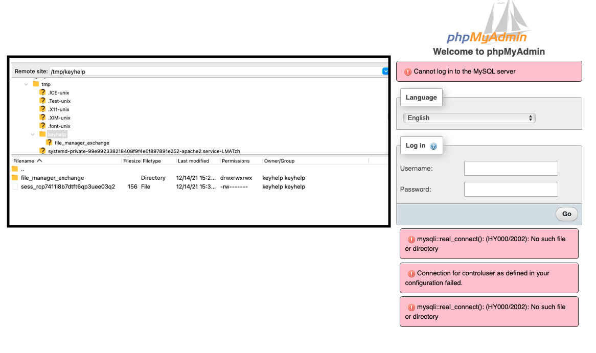

Thank you for your answer... still show error.

What have you done before? What changes have you performed on your server?
You may want to check /home/keyhelp/www/phpmyadmin/config.inc.php
and try changing the 'host' value to '127.0.0.1'

I add 'host' => '127.0.0.1', but still show same error.

check /var/log/syslog why MariaDB is not starting. Also check that your HDD is not completely occupied.

Try to restart the database server and then immediately check the log.
Also check if something is logged into /var/log/mysql/error.log
