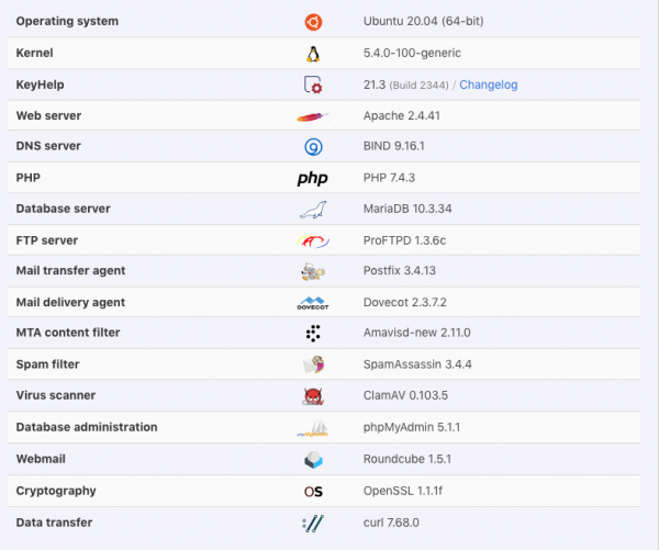

i have a problem that arises when i launch a cron of a prestashop module.
Cannot write to pid file /../../tmp/PidImportController.php.pid Program execution halted.
strangely on other servers this problem does not arise. what should i check or change ??
