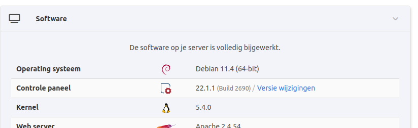

Re: Frage zu OpenVZ - upgrade auf Debian 11
Hat fur mich geklappt, kein problem
They just change the kernel to a more modern version, after you can run the script and it updates to the latest and greatest.
Only thing is, their own panel keeps saying it's a very old Debian, but that doesn't matter.
After the Kernel update, I ran the script from KeyHelp for updating....and hoppa, latest version.
They must update the kernel to 5.4.0, else you get problems with systemd if I'm not mistaken.
Most hosters do refuse as they don't want to solve problems if it doesn't work for you.
But they can simply announce a new kernel in your Open VZ VPS that has been released by OpenVZ.
Latest is: uname -a
Linux 5.4.0 #1 SMP Fri Dec 31 04:05:16 MSK 2021 x86_64 GNU/Linux
Latest is: uname -a
Greetings Bas.
