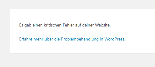

The problem with Wordpress and PHP >= 8 is AFAIK the PHP function error_log().
In KeyHelp Versions < 22.2 this function is on the list of „disabled PHP functions“.
It must be enabled (delete it from the list) and Wordpress will work.

Yes, I can confirm that Wordpress 6.0.2 can be installed on a Keyhelp server and runs without problems at least with PHP 8.0, when error_log is removed from the list of disabled functions. Ok, I removed some more, which might not have been necessary, but at least I'm sure I removed error_log. Found the info about disabled error_log function in the PHP error log.

'PHP message: PHP Fatal error:  Uncaught Error: Call to undefined function error_log() in /home/users/mlan/www/wp-includes/wp-db.php......
