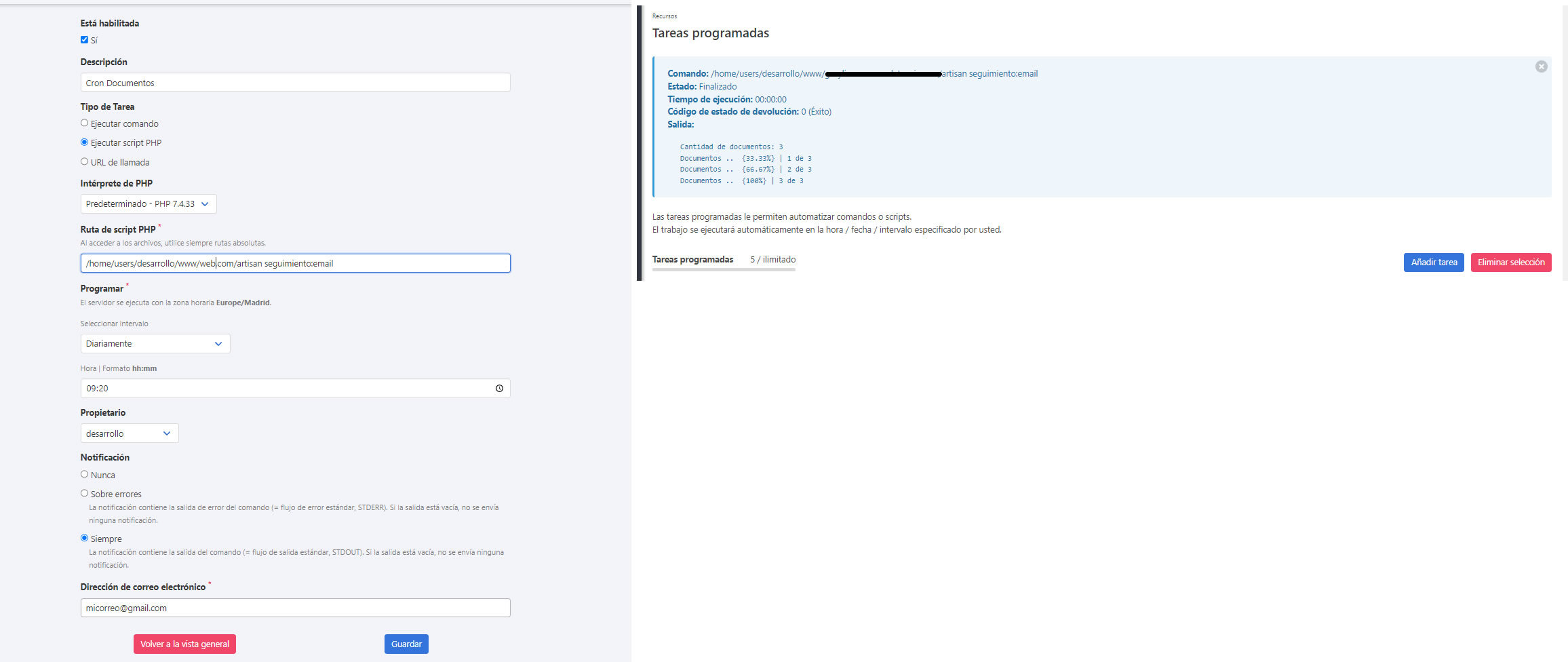

kurgans
Posts: 16
Re: Cron jobs not sending mail
Post by kurgans »
Thanks for the recommendation for the translator
Correct, the output I have set is crontab -u desarrollo -e,
I attach the image of keyhelp
Thanks
Posts: 3840
It seems, that the output of the called script does not write to the STDOUT stream (standard output), and therefor may not be captured by the Cron-Daemon. What software do you use?
Some ideas to further investigate:
- Run this command (artisian seguimiento:email) on the CLI itself and see, how it behaves, make sure there are no interactive messages by the script etc.
- Check the code of the script and how it outputs the data
- Create a wrapper script, where you catch the output of your script and call this wrapper script as cronjob, instead of "artisian seguimiento:email"
- Redirect the STDERR to STDOUT by adding "2>&1" to the end of the command e.g. "... artisian seguimiento:email 2>&1"
- Check if the Cron-Daemon would send an emails when just calling a simple test script e.g. " <?php echo 'Test'; "
