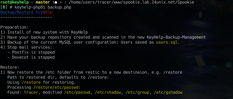

Work in Progress. That's was it already does:
It needs to be run as root (Debian) or via sudo (Ubuntu).
keyhelp-php81 backup.phpTODO:

The current state of the script (most critical calls are commented, as they were tested and will be reenabled after the script is finished:

Backup/Restore KeyHelp
Preparation:
1) Install of new system with KeyHelp
2) Have your backup repository created and scanned in the new KeyHelp-Backup-Management
3) Backup of the current MySQL user configuration: Users saved as users.sql.
4) Stop mail services:
- Postfix is stopped
- Dovecot is stopped
Restore:
1) Now restore the /etc folder from restic to a new destinaion, e.g. /restore
Path to restored dir, defaults to /restore: 1
Using 1 for restoring.
Processing 1/etc/passwd:

You must enter a path, I guess "1" is neither a path nor does it contain the restored data, right?PuntonetSvb wrote: ↑Mon 30. Jan 2023, 15:47 1) Now restore the /etc folder from restic to a new destinaion, e.g. /restore

Re: Automate complete restore of a Restic server backup
Restore:
Using /restore for restoring.
Processing /restore/etc/passwd:
I make restore dir and other files manually, and now i see it when run script
