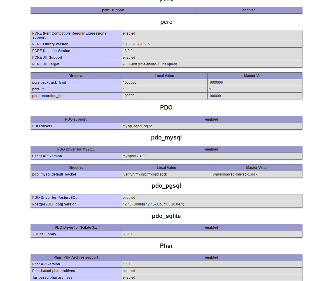

But, I can not find extension here (attachment)

it is working without any issues:
pecl install pdo_sqlsrv-5.10.0
echo "extension=pdo_sqlsrv.so" > /etc/php/7.4/mods-available/pdo_sqlsrv.ini
phpenmod pdo_sqlsrv
/etc/init.d/php7.4-fpm restart
Result:
