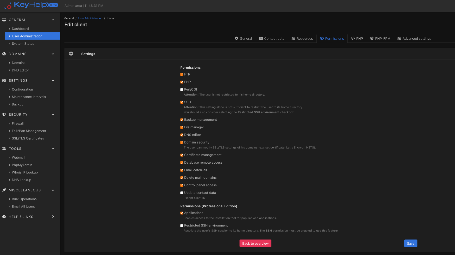

There is only one allowed SSH user (as per configured in the ssh server with the AllowUsers), which is the one generated originally with the Ubuntu install. This the mayor problem now that I recall.
But I don´t remember If I've changed this behavior. How Can i create one with KeyHelp? I don't see that option, but is AllowUsers still active, I believe won't matter.

gusarg81 wrote: Wed 27. Nov 2024, 23:44 How Can i create one with KeyHelp?
Add the checkmark to SSH.

Oks, thanks. The problem is that user will not have sudo permissions for sure in case I need to fix SSH access. Or I am wrong?

Oks guys, I've fixed the problem.
I have access with my user created with KeyHelp panel (by adding SSH permission) and then later inside the server, su - myuser.
To the problem seems that accidentally changed AllowUsers to an user from the Keyhelp panel (where is my mind these days!), which was the one I was available to login.
