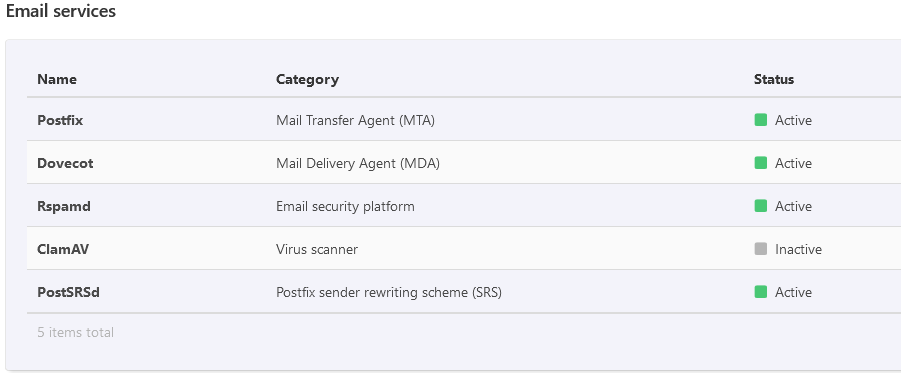

ClamAV failed to restart after upgrading KeyHelp
Expected result
Actual result
Steps to reproduce
Additional information
(e.g. recent changes to the server, excerpts from log files (/var/log/*, /var/log/keyhelp/php-error.log, etc.))
error
"Failed to restart clamav-daemon.service: Unit clamav-daemon.socket is masked"
When I try to start the service in the control panel (Server Service Management) I get this error
"The operation could not be completed. Please check the necessary permissions."
