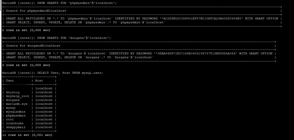

As the subject line indicates, after updating a Debian 12 to 13 VPS, I see that the phpmyadmin user has lost the privileges it had to manage users, so new users cannot be created outside the panel to assign them to existing databases.
I have manually created a user called kurgans with all the privileges as root, but user management is still not accessible.

I am not aware of that the dist-upgrade from 12 to 13 removes the GRANT option from root accounts. If this will generally be the case, i guess there would have been some messages in the forum about this.
To fix your issue and create an account, which is able to use the GRANT command and manage other user privileges, you have to create it like this:
GRANT ALL PRIVILEGES ON *.* TO 'kurgans'@'localhost' IDENTIFIED BY '<YOUR PASSWORD>' WITH GRANT OPTION
With this account you should be able use the user management.

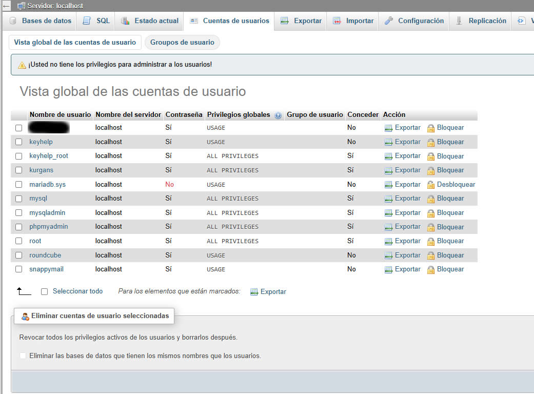

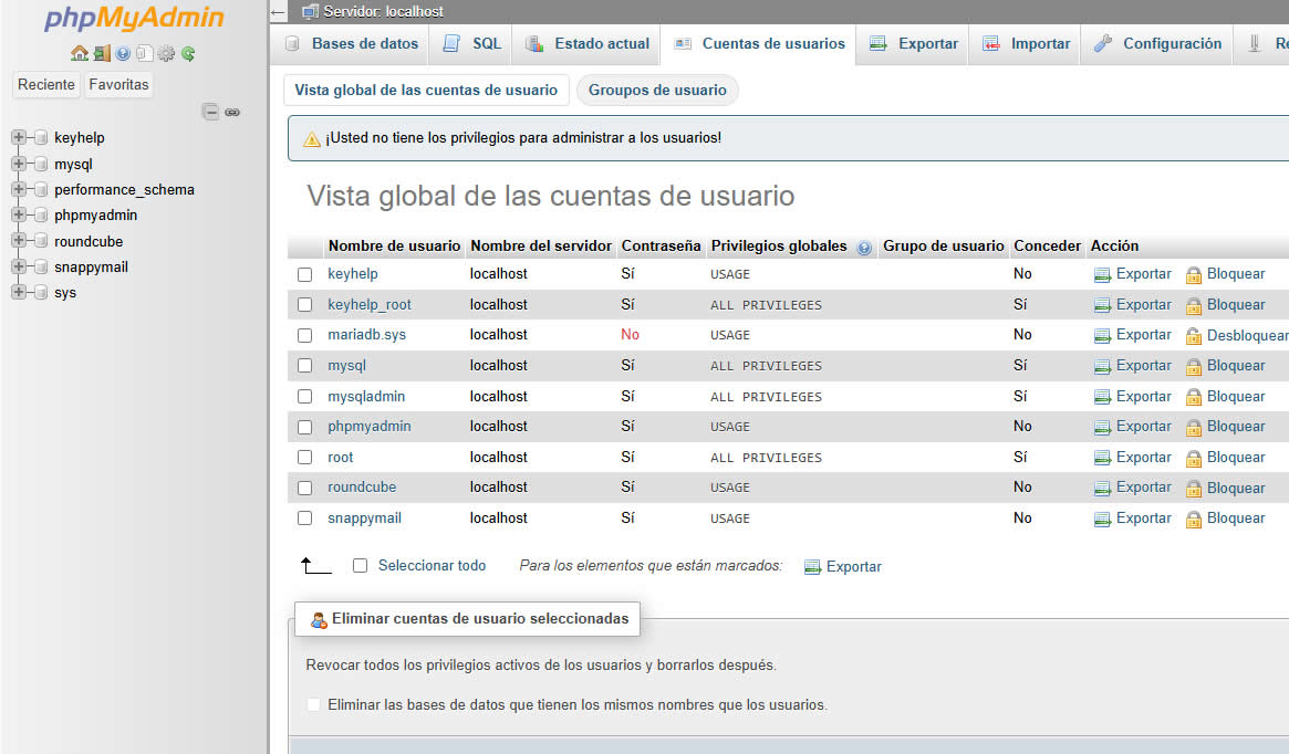

As I mentioned, I have reinstalled a new server. I haven't added anything yet, just to verify the phpmyadmin permissions in Debian 1. The result is the same, although the option to create a user outside the panel and assign them to a database or another database so that both users can share access has been lost.
Here's a screenshot of Debian 12 and another of Debian 13 where you can see that this option is not available.
Thank you all and my apologies for the delay these past few days.

Posts: 4819
Re: Lost privileges on users in phpmyadmin with the phpmyadmin user after updating Debian 12 to 13
With which user you were logged in as taking the screenshots?
Still cannot reproduce this. Should i take a look at phpMyAdmin on your server?
