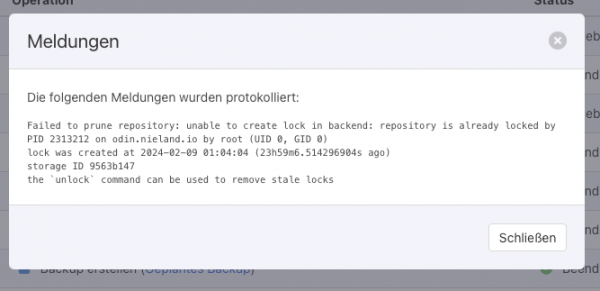

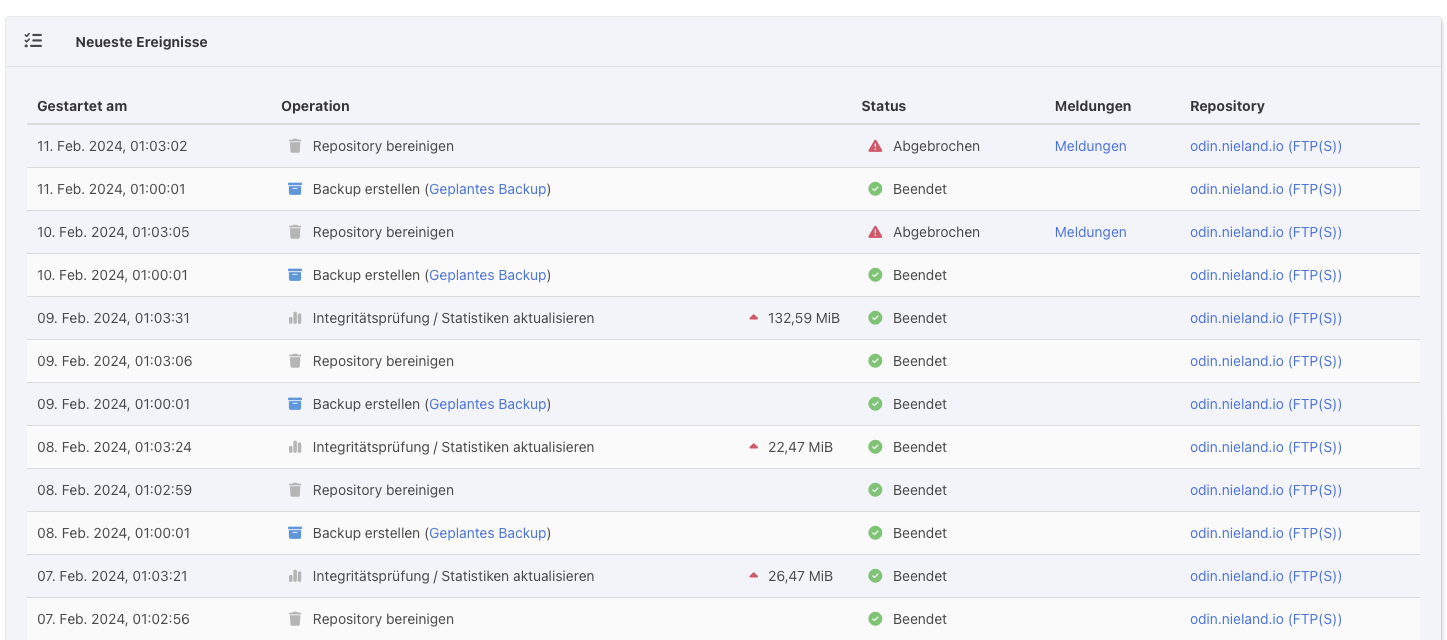

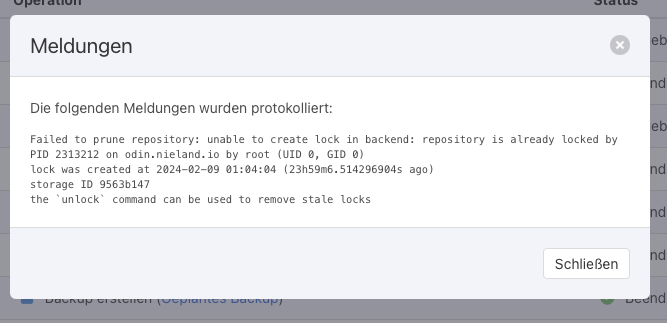

auch ich habe Problem mit dem Backup. Anbei das Log, sowie Screenshots.
Wenn noch anderweitige Daten erforderlich sind, bitte melden.
Ich habe über die Problembehandlung das Repository entsperrt und werde berichten, ob es heute Nacht wieder normal durchgelaufen ist.
[10-Feb-2024 01:00:02] INFO | Create repository lock
[10-Feb-2024 01:00:04] INFO | Looking for pending operations for repository: odin.nieland.io (FTP(S)) / #1
[10-Feb-2024 01:00:04] INFO | Operation found: backup
[10-Feb-2024 01:00:04] INFO | Prepare backup...
[10-Feb-2024 01:03:05] INFO | Backup created
[10-Feb-2024 01:03:05] INFO | Cleanup
[10-Feb-2024 01:03:05] INFO | Operation found: prune
[10-Feb-2024 01:03:05] INFO | Remove old snapshots
[10-Feb-2024 01:03:10] ERROR | Failed to prune repository: unable to create lock in backend: repository is already locked by PID 2313212 on odin.nieland.io by root (UID 0, GID 0)
lock was created at 2024-02-09 01:04:04 (23h59m6.514296904s ago)
storage ID 9563b147
the `unlock` command can be used to remove stale locks
[10-Feb-2024 01:03:11] INFO | All finished, releasing lock.
[11-Feb-2024 01:00:01] INFO | Create repository lock
[11-Feb-2024 01:00:03] INFO | Looking for pending operations for repository: odin.nieland.io (FTP(S)) / #1
[11-Feb-2024 01:00:03] INFO | Operation found: backup
[11-Feb-2024 01:00:03] INFO | Prepare backup...
[11-Feb-2024 01:03:02] INFO | Backup created
[11-Feb-2024 01:03:02] INFO | Cleanup
[11-Feb-2024 01:03:02] INFO | Operation found: prune
[11-Feb-2024 01:03:02] INFO | Remove old snapshots
[11-Feb-2024 01:03:12] ERROR | Failed to prune repository: unable to create lock in backend: repository is already locked by PID 2313212 on odin.nieland.io by root (UID 0, GID 0)
lock was created at 2024-02-09 01:04:04 (47h59m3.652696162s ago)
storage ID 9563b147
[11-Feb-2024 01:03:13] INFO | All finished, releasing lock.
