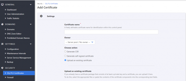

Thank you for the suggestion, I've installed & configured certbot and issued a certificate with wildcard.
My only problem is, how exactly do I integrate it with KeyHelp ?
Would a small hack like, deleting the complete.pem & chain.pem files and crating symbolic links to /etc/letsencrypt/live work or would they be re-generated again when the certificate is renewed ?
Or maybe just make /etc/ssl/keyhelp/letsencrypt/ a symbolic link to /etc/letsencrypt ?

Victor
Posts: 17
Joined: Sun 21. Jun 2020, 20:23
Re: Cloudflare DNS Proxy with Letsencrypt error.
Post by Victor »

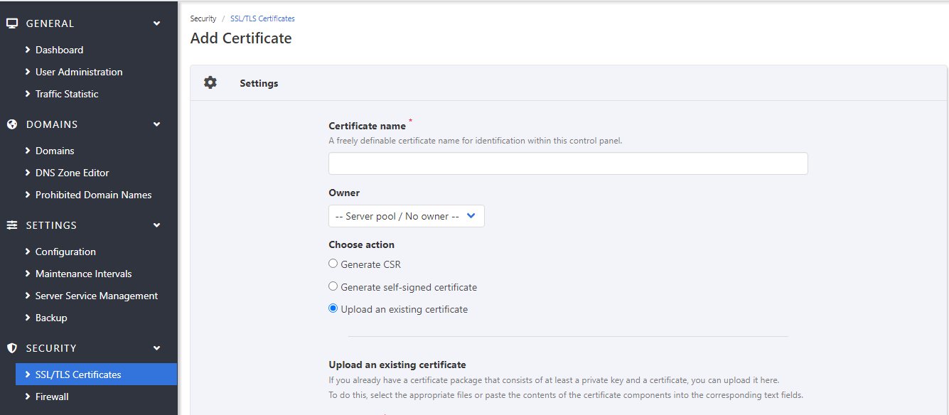

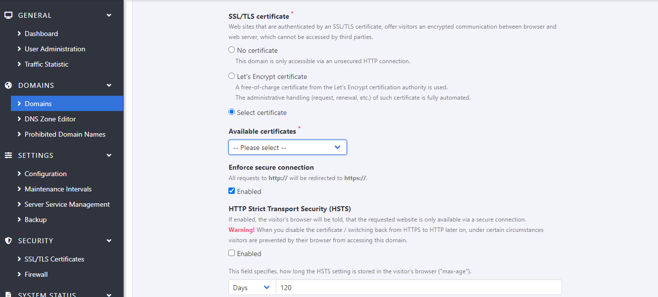

Thank you latifolia for the suggestion,
I've managed to get it to work, it's a bit of a long procedure to convert every domain on the server, but it's worth it.
On a side note, after you upload the generated wildcard certificates you must activate them on each domain before making the symbolic links to /etc/lentsencrypt/live/ or else you won't be able to choose them later from the dropdown list. Also, the details about the certificate and expiration date disappear from the panel interface after you delete them and create symbolic links but they do still work after you restart apache.
For now it works, I even installed the wildcard certificate for the panel domain without problems. I just hope nothing gets overwritten in a KeyHelp future update and that there won't be any problems when the certificates will be auto-renewed with certbot.
