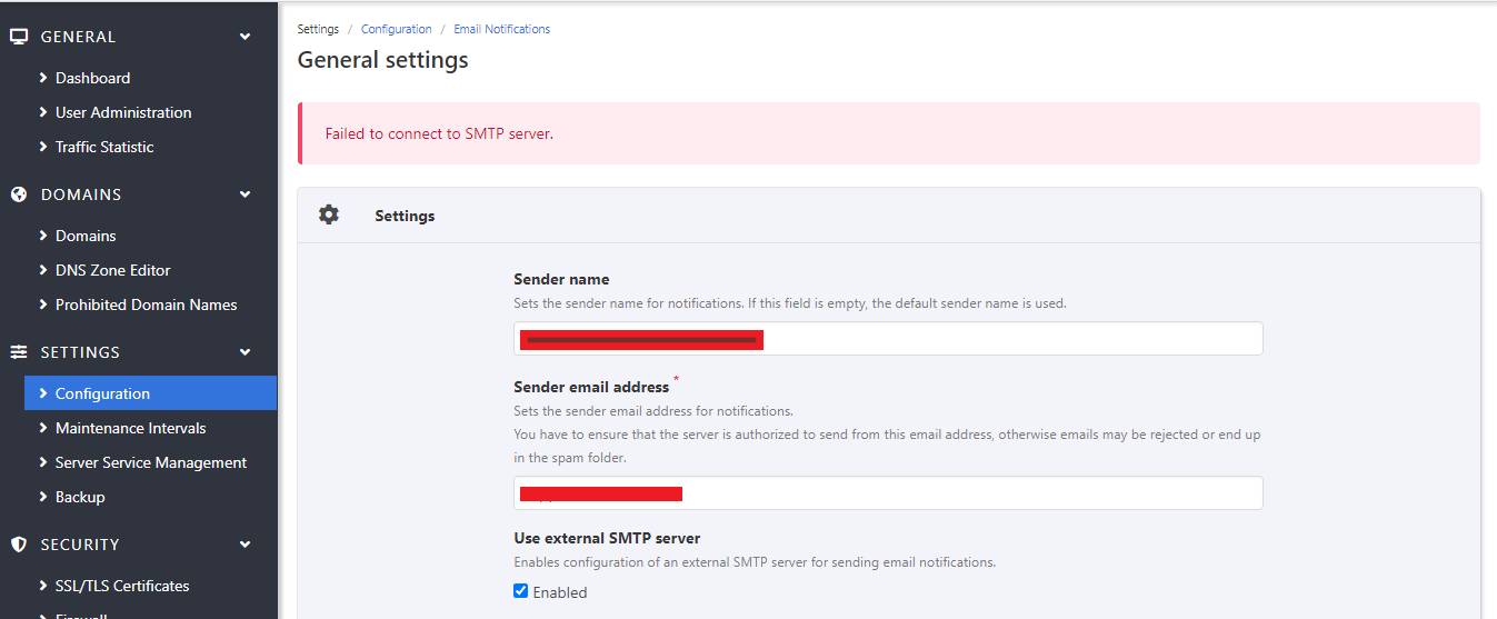

I tried to configure Email Notifications from server to registered users via external SMTP (gmail smtp) but always failed with error :
Failed to connect to SMTP server
Why is that ? gmail smtp at : smtp.gmail.com port 587 with username and password generated-app via gmail security console. The same settings works on my other server (not keyhelp server).

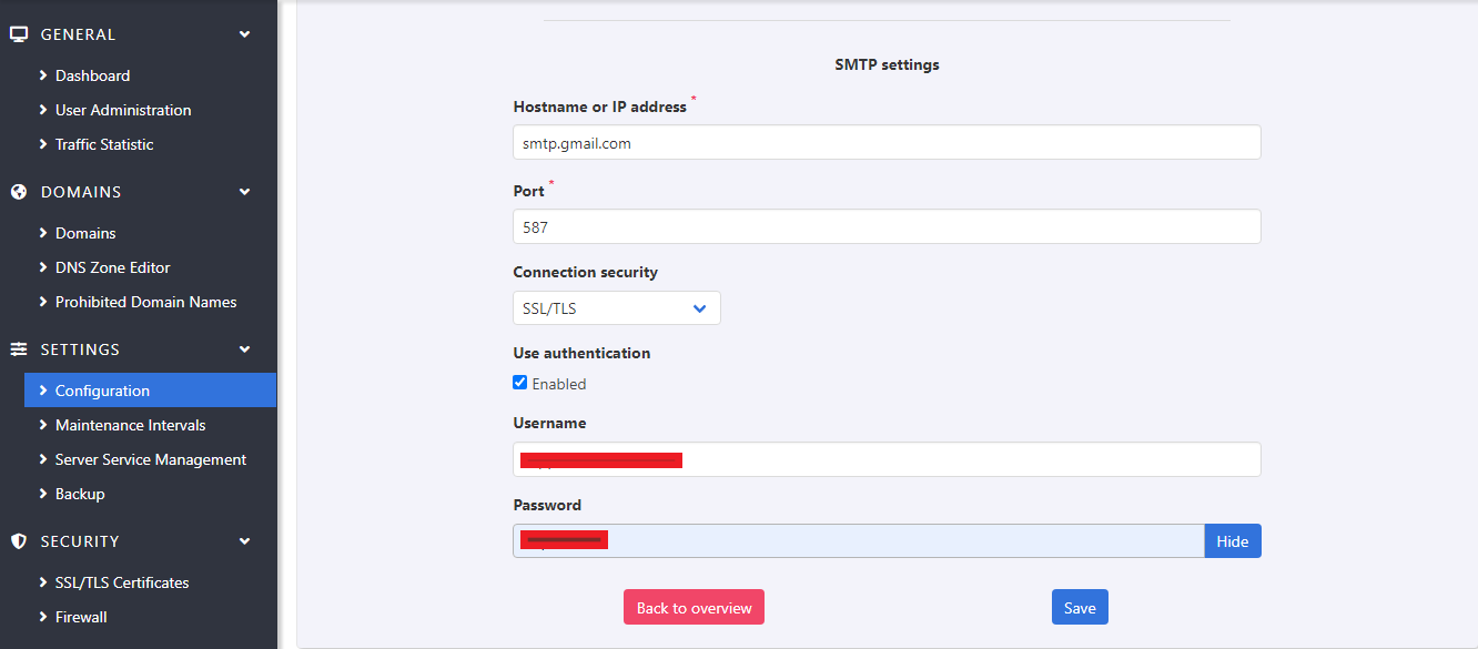

Hello, I try to configure Email Notifications as in attached images. Yes, Less Secure apps is active more than a year ago and still activly used in different postfix mail server (not keyhelp). We try to move into KeyHelp from that mail server.

if you use Port 587 you must choose STARTTLS and not SSL/TLS

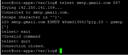

Tried multiple times with STARTTLS or SSL/TLS.. both of them always Failed.
Here attached successfull Telnet to Gmail SMTP firectly from KeyHelp shell console (via SSH).
