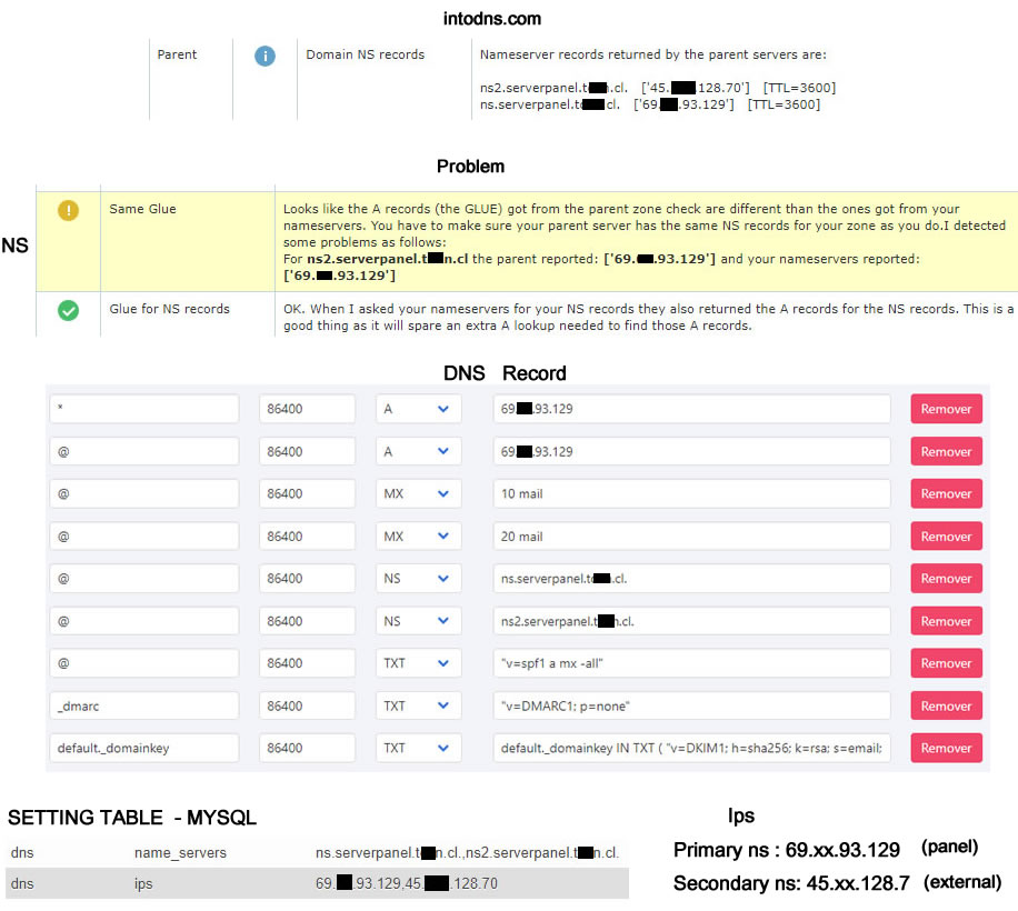

I'm new to the forum and i'm trying out this panel and it seems good. I've intalled it with no problem in Debian 11, and in general everything seems ok but I don´t know how to configure a secudary external DNS and it shows an error that I attach in the following figure.
It contains:
analysis intodns.com
ns2.serverpanel.txxxn.cl. ['45.xx.128.70'] [TTL=3600]
ns.serverpanel.txxxn.cl. ['69.xx.93.129'] [TTL=3600]
Warning in glue record
the dns record for the main domain
settings ns nameservers and IPs in database
ipservers primary and secondary
warning Image
I'm thankful for any help.
Kind regards
Pedro P.

no, the problem remains
My config
Setting -->DNS sever
ns.serverpanel.txxn.cl.  	(default)
ns3.txxn.cl			(external)
Here my domain DNS conf (panel)
*			86400 A 	69.xx.93.129
ns.serverpanel.toxx.cl 	86400 A 	69.xx.93.129
ns3.toxx.cl		86400 A 	45.xxx.128.70
@ 			86400 NS 	ns.serverpanel.txxn.cl.
@ 			86400 NS 	ns3.txxn.cl.
Here the intodns.com result
PARENT (OK)
Domain NS records	Nameserver records returned by the parent servers are:
			ns.serverpanel.txxn.cl.   	['69.xx.93.129']   [TTL=3600]	(OK)
			ns3.txxn.cl.  			['45.xxx.128.70']  [TTL=3600]	(OK)
NS (wrong)
NS records from your nameservers	NS records got from your nameservers listed at the parent NS are:
					ns.serverpanel.txxn.cl  ['69.xx.93.129']   [TTL=86400]
					ns3.txxn.cl  ['69.xx.93.129']   [TTL=86400] --> WRONG the real IP is 45.xxx.128.70)
WARNING
Same Glue	Looks like the A records (the GLUE) got from the parent zone check are different than the ones got from your nameservers.
		You have to make sure your parent server has the same NS records for your zone as you do.I detected some problems as follows:
                For ns3.txxn.cl the parent reported: ['45.xxx.128.70'] and your nameservers reported: ['69.xx.93.129']
S.O. : Debian 11
Panel : 22.0 (Build 2393)
DNS server: BIND 9.16.27
DB server: MariaDB 10.5.15
Thanks in advance, any help is appreciated

Hi, I´ve resolved this issue, and nothing to do with the MX as you suggest me
1.- Edit /etc/bind/named.conf.options and change adding the secondary DNS IP to look like
	// If BIND logs error messages about the root key being expired,
	// you will need to update your keys.  See https://www.isc.org/bind-keys
	dnssec-validation auto;
	auth-nxdomain no;    # conform to RFC1035
	listen-on-v6 { any; };
	allow-transfer {
		127.0.0.1;
		45.236.108.270;  --->  (ip secondary DNS)
     also-notify {
     45.236.108.270;           ----> (ip secondary DNS)
After that, runs the followin commands to ensure that everything is OK
named-checkconf (no response is everything OK)
service bind9 reload
service bind9 restart
service bind9 status
2.- Add the new Ip to the DNS config
Edit /etc/bind/keyhelp_domain.conf
change the existent IP for the secondary server IP and should like as
; Glue
ns IN A 45.71.231.70
ns2 IN A 45.236.108.270    ---> secondary IP
I recommend reboot the system
I´ts worked for me
Debian 11
Keyhelp 22.1
Based in this post: viewtopic.php?t=9000
