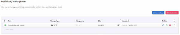

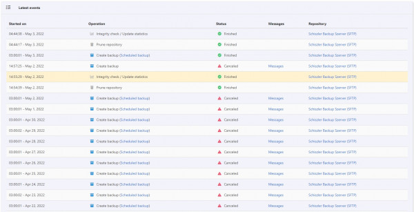

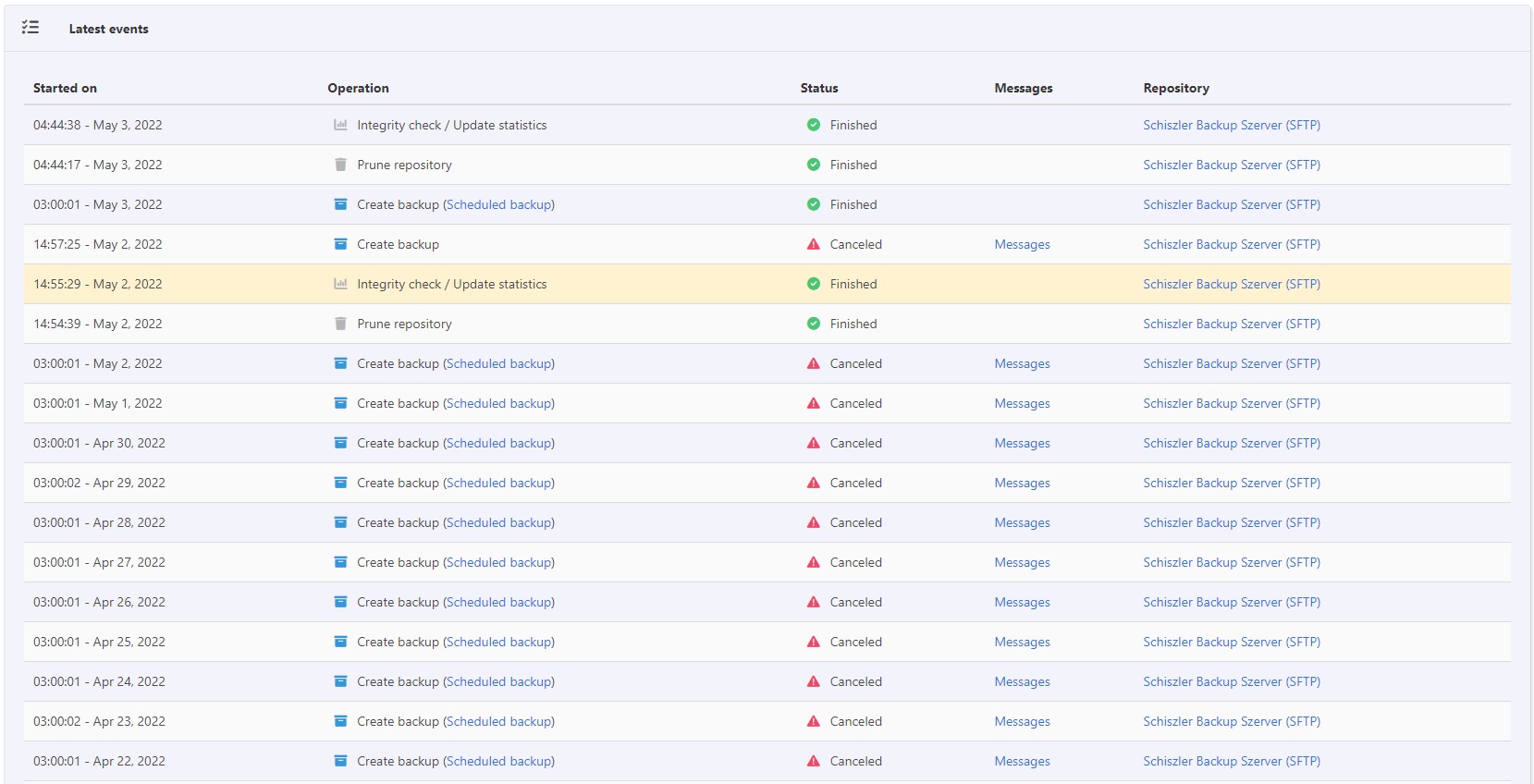

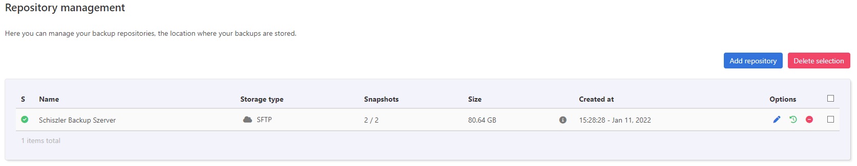

expanded space +50 GB yesterday. Now: Free: 57.21 GB Used: 80.11 GB Total: 144.69 GB
Changed backup snapshot from 5 to 2. Backup ran successfully as last night. The snapshot was the fault or the space?
Repository management
Event log
Event log
