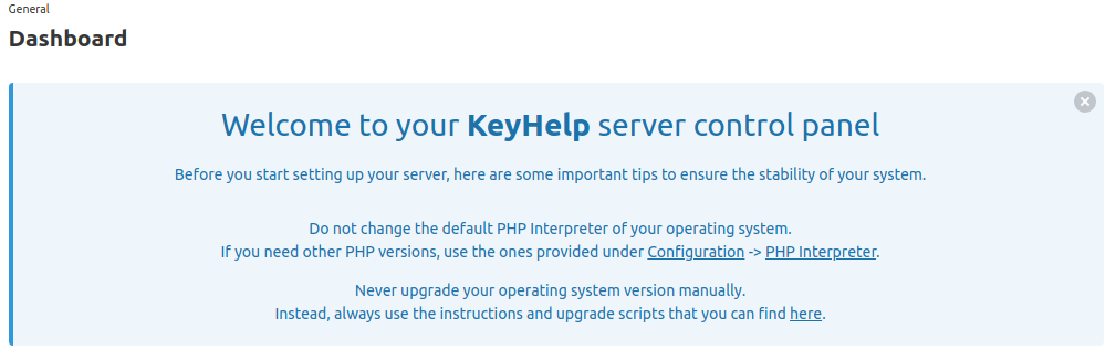

you have seen this message? Especially the second paragraph?
You have to revert your changes and never touch the system OS default PHP version.
KeyHelp offers additional PHP-Interpreters, see the screenshot, where to find them.
to note, my current "Default PHP version of the operating system" which is shown by keyhelp is still 7.4.3
Yes, as the KeyHelp UI luckily for you still is configured to runs with PHP 7.4 on your system.
But background tasks run with the command "php". And there you have configured it should use PHP 8.1, instead of the default PHP 7.4.
Try this command, to see what I mean.
php -v

I missed the information provided on your screenshot, probably i closed it on the past.
yeah my system php version is now 8.1 and the keyhelp UI is still using php 7.4
