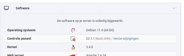

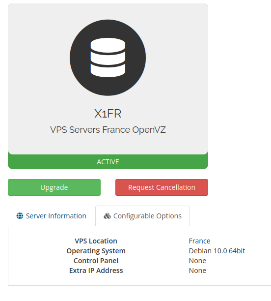

Hat fur mich geklappt, kein problem :D
They just change the kernel to a more modern version, after you can run the script and it updates to the latest and greatest.
Only thing is, their own panel keeps saying it's a very old Debian, but that doesn't matter.
After the Kernel update, I ran the script from KeyHelp for updating....and hoppa, latest version.
They must update the kernel to 5.4.0, else you get problems with systemd if I'm not mistaken.
