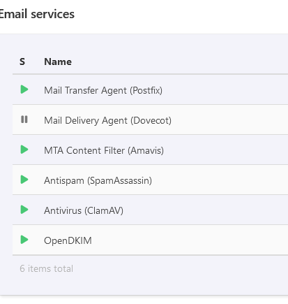

After Rebooting the server Mail Delivery Agent (Dovecot) service Stop.
When I click restart I get the following error message.
Sorry, the operation could not be performed correctly. (Permissions correct?)

What gives
systemctl status dovecot.service
What
grep dove /var/log/mail.info|tail -30
Tony20 wrote: Sat 18. Feb 2023, 14:49 I had Disable IPv6 on Ubuntu via GRUB Boot Loader.
GRUB_CMDLINE_LINUX="ipv6.disable=1"
Why?

24unix wrote: Sat 18. Feb 2023, 15:00 What gives
root@panel:~# systemctl status dovecot.service
× dovecot.service - Dovecot IMAP/POP3 email server
Loaded: loaded (/lib/systemd/system/dovecot.service; enabled; vendor prese>
Active: failed (Result: exit-code) since Sat 2023-02-18 14:22:20 CET; 2h 2>
Docs: man:dovecot(1)
https://doc.dovecot.org/
Process: 19813 ExecStart=/usr/sbin/dovecot -F (code=exited, status=89)
Main PID: 19813 (code=exited, status=89)
CPU: 21ms
Feb 18 14:22:20 panel.x.com dovecot[19813]: master: Error: service(imap-lo>
Feb 18 14:22:20 panel.x.com dovecot[19813]: Error: socket() failed: Addres>
Feb 18 14:22:20 panel.x.com dovecot[19813]: Error: service(imap-login): li>
Feb 18 14:22:20 panel.x.com dovecot[19813]: master: Error: socket() failed>
Feb 18 14:22:20 panel.x.com dovecot[19813]: Fatal: Failed to start listene>
Feb 18 14:22:20 panel.x.com dovecot[19813]: master: Fatal: Failed to start>
Feb 18 14:22:20 panel.x.com systemd[1]: dovecot.service: Main process exit>
Feb 18 14:22:20 panel.x.com systemd[1]: dovecot.service: Failed with resul>
Feb 18 14:22:20 panel.x.com systemd[1]: Failed to start Dovecot IMAP/POP3 >
lines 1-19/19 (END)...skipping...
Loaded: loaded (/lib/systemd/system/dovecot.service; enabled; vendor preset: enabled)
Active: failed (Result: exit-code) since Sat 2023-02-18 14:22:20 CET; 2h 27min ago
CPU: 21ms
Feb 18 14:22:20 panel.x.com dovecot[19813]: master: Error: service(imap-login): listen([::], 143) failed: Address family not supported by protocol
Feb 18 14:22:20 panel.x.com dovecot[19813]: Error: socket() failed: Address family not supported by protocol
Feb 18 14:22:20 panel.x.com dovecot[19813]: Error: service(imap-login): listen([::], 993) failed: Address family not supported by protocol
Feb 18 14:22:20 panel.x.com dovecot[19813]: master: Error: socket() failed: Address family not supported by protocol
Feb 18 14:22:20 panel.x.com dovecot[19813]: master: Error: service(imap-login): listen([::], 993) failed: Address family not supported by protocol
Feb 18 14:22:20 panel.x.com dovecot[19813]: Fatal: Failed to start listeners
Feb 18 14:22:20 panel.x.com dovecot[19813]: master: Fatal: Failed to start listeners
Feb 18 14:22:20 panel.x.com systemd[1]: dovecot.service: Main process exited, code=exited, status=89/n/a
Feb 18 14:22:20 panel.x.com systemd[1]: dovecot.service: Failed with result 'exit-code'.
Feb 18 14:22:20 panel.x.com systemd[1]: Failed to start Dovecot IMAP/POP3 email server.
Why?
It look it's the disabling of the IPv6. the cause.

Posts: 1643
Re: Service: Mail Delivery Agent (Dovecot) Stop
Tony20 wrote: Sat 18. Feb 2023, 16:40 I did it, because I don't need the IPv6, I just like the IPv4.
You are ignoring the future.
You output is truncated. Make the Terminal larger.
"Error: socket() failed: Address" could be "is already in use".
What gives
netstat -luntep|grep 143
Try
dovecot -F
to get a more verbose output.
mfg Micha
… oh wait, he does.

24unix wrote: Sat 18. Feb 2023, 16:51
What gives
I get nothing with this
Try
dovecot -F
root@panel:~# dovecot -F
Error: service(managesieve-login): listen([::], 4190) failed: Address family not supported by protocol
Error: service(pop3-login): listen([::], 110) failed: Address family not support ed by protocol
Error: service(pop3-login): listen([::], 995) failed: Address family not support ed by protocol
Error: service(imap-login): listen([::], 143) failed: Address family not support ed by protocol
Error: service(imap-login): listen([::], 993) failed: Address family not support ed by protocol
Posts: 1643
Re: Service: Mail Delivery Agent (Dovecot) Stop  [SOLVED]
Dovecot tries to bind to an IPv6 address, which it cannot, as you've disabled it.
Either enable IP6 (better) or disable IPv6 in Dovecot.
mfg Micha
