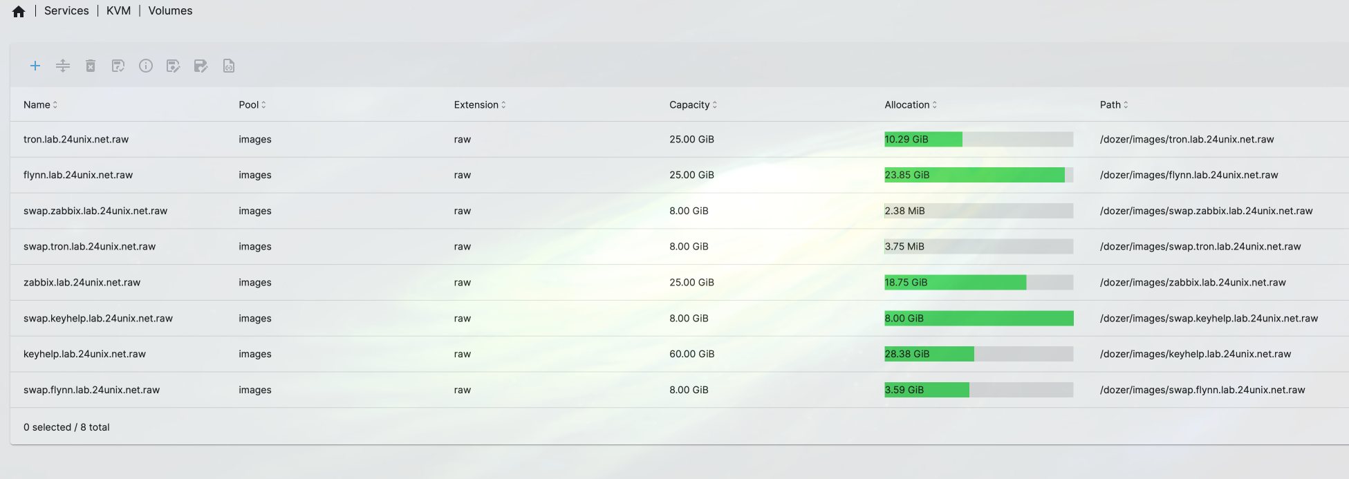

I'd suggest another approach: Create a KVM VM, inside install a plain Debian with EXT4.
I have a similar setup at home, not with Proxmox, but with OMV, that uses the Proxmox kernel with ZFS.
One of the VM ist my testing and developing KeyHelp.

theqkash wrote: Mon 10. Apr 2023, 14:45 @24unix this will ruin my whole backup solution I have now where I am just making ZFS snapshots for every container on server which works great and which is flexible and fast. But has some cons like this one. I’ve more considering putting kvm and setting zfs inside and backuping inside zfs partition but this will omit some zfs features I would like to stay with me.
Why?
My KVM image reside on a ZFS Volume, so snapshots are possible without problems.
