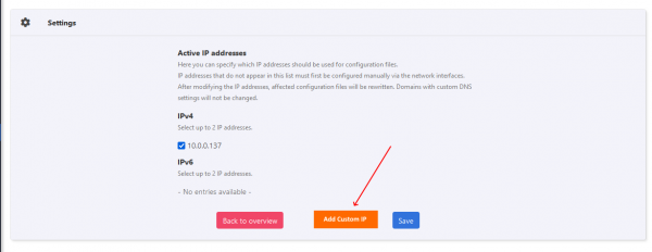

  • (preferred) Add a custom IP option to: Settings --> Configuration --> IP Addresses - This could be then used to build all configs as normal and this IP would not be present on the NIC.

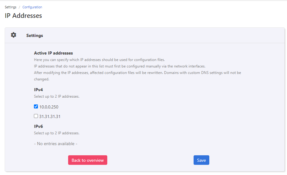

didn't work, the loopback adapter is ignored when looking at the adapters for information.
However, you can add the real IP to your normal network card as follows:
https://askubuntu.com/questions/585468/ ... -ubuntu-14
# The primary network interface
allow-hotplug ens3
iface ens3 inet static
    address 10.0.0.250
    netmask 255.255.255.0
    gateway 10.0.0.1
#secondary ip address
auto ens3:0
iface ens3:0 inet static
    address 31.31.31.31
    netmask 255.255.255.255
restart the network with: /etc/init.d/networking restart
Once the IP(s) have been selected, they are then stored in KeyHelp which means adding a custom field would be an extremely easy thing to do and therefore add NAT support.
Settings --> Configuration --> System --> IP Addresses
But I am not happy with this as a permanent solution as I need to remove the NIC IP alias.

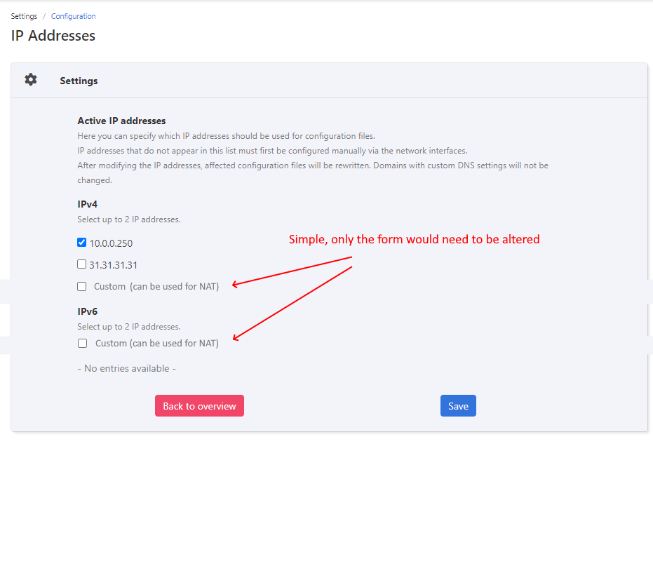

You will loose a massive install base for what is a simple thing to add :cry: . here is a list just to show to the developers of KeyHelp it is a thing that people use.
  • CWP
  • Virtualmin
  • HestiaCP
  • myVesta
There are more but I have not checked this feature.
