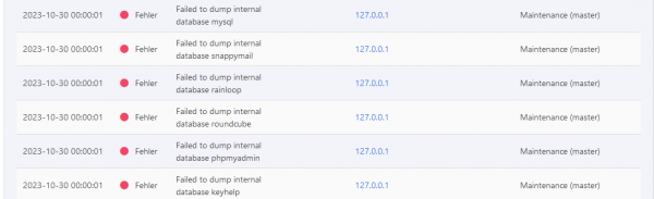

Sicherung der internen DB schlägt fehl
Erstmals 23.10, ab da alle 24 Std.
[PID-537084] [29-Oct-2023 00:00:02] DEBUG | Event log rotation performed.
[PID-537084] [29-Oct-2023 00:00:02] DEBUG | Event log IPs anonymized.
[PID-537084] [29-Oct-2023 00:00:02] INFO | cleanup roundcube contacts
[PID-537084] [29-Oct-2023 00:00:02] INFO | check rspamd configuration for outdated secure_ip configuration in worker-controller
[PID-537084] [29-Oct-2023 00:00:02] INFO | perform internal database backups
[PID-537084] [29-Oct-2023 00:00:02] ERROR | error while dumping internal database "keyhelp"
[PID-537084] [29-Oct-2023 00:00:02] ERROR | error while dumping internal database "phpmyadmin"
[PID-537084] [29-Oct-2023 00:00:02] ERROR | error while dumping internal database "roundcube"
[PID-537084] [29-Oct-2023 00:00:02] ERROR | error while dumping internal database "rainloop"
[PID-537084] [29-Oct-2023 00:00:02] ERROR | error while dumping internal database "snappymail"
[PID-537084] [29-Oct-2023 00:00:02] ERROR | error while dumping internal database "mysql"
[PID-537084] [29-Oct-2023 00:00:02] INFO | clean up file manager exchange directory
[PID-537084] [29-Oct-2023 00:00:02] INFO | jobs to run: update.php, statistic.php
[PID-537084] [29-Oct-2023 00:00:02] INFO | >>> trying to run "update"
[PID-537084] [29-Oct-2023 00:00:02] INFO | lock "update" acquired
[PID-537084] [29-Oct-2023 00:00:02] INFO | processing the job ...
[PID-537084] [29-Oct-2023 00:00:02] INFO | <<< job done, releasing lock "update"
[PID-537084] [29-Oct-2023 00:00:02] INFO | >>> trying to run "statistic"
[PID-537084] [29-Oct-2023 00:00:02] INFO | lock "statistic" acquired
[PID-537916] [29-Oct-2023 00:01:01] INFO | jobs to run: update.php, ssl_maintenance.php
[PID-537916] [29-Oct-2023 00:01:01] INFO | >>> trying to run "update"
[PID-537916] [29-Oct-2023 00:01:01] INFO | lock "update" acquired
[PID-537916] [29-Oct-2023 00:01:01] INFO | processing the job ...
[PID-537916] [29-Oct-2023 00:01:01] INFO | <<< job done, releasing lock "update"
[PID-537916] [29-Oct-2023 00:01:01] INFO | >>> trying to run "ssl-maintenance"
[PID-537916] [29-Oct-2023 00:01:01] INFO | lock "ssl-maintenance" acquired
[PID-537916] [29-Oct-2023 00:01:19] INFO | <<< job done, releasing lock "ssl-maintenance"
[PID-537084] [29-Oct-2023 00:01:50] INFO | <<< job done, releasing lock "statistic"
Eine erfolgreiche Sicherung wäre ganz nett ^^
Nen anderes als das erwartete ?! ^^ :lol:
Wenn ich das wüsste, gäb es kein Problem ;)
Ausser der obrigen Ausgabe von /var/log/keyhelp/cronjob/master.log, keine weiteren.
Beim zurückschauen war festzustellen, dass dies wohl schon ein paar Tage so ist.
Erstmals aufgetretten scheint das Problem nach einem Recovery.
Da es aber während der Wiederherstellung zu keinen Warn / Error Meldungen kam, steh ich grad bissel auf dem Schlauch.
