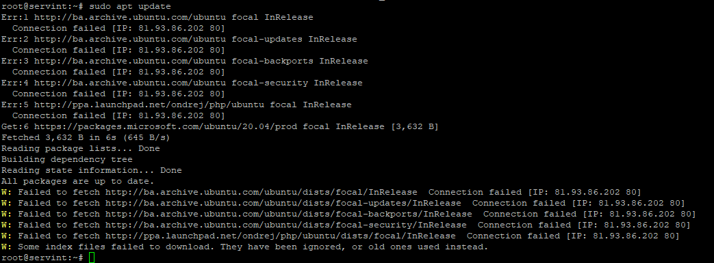

I think it is because this started to happen after the last update of Keyhelp.
Everything was working fine until.
I asked the guy who working at the network did they made some changes, but they said that nothing has changed.
Ubuntu 20.04
24.0 (Build 3220)
When I run an update on my VM, this error shows up (attachment).
Can you help me to debug the issue
VM is running in our internal network.

Posts: 2106
Re: Unable to update
I cannot even ping the host where your systems tries to fetch its repos.
Try a different mirror.
Post by BasHeijermans »
Check your DNS settings....

Posts: 2106
Re: Unable to update  [SOLVED]
The topic is one week old, today the IP is reachable (again).
