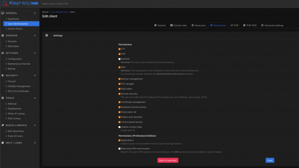

Re: Can' t log in via SSH to my server anymore
Do you have any other ssh-enabled user?
(If not, you could add one via the panel)
If yes, can he login?
If yes: can he su - (and then root password)
Or can he sudo -i
Add the checkmark to SSH.
But, Alex already offerred help, there is nobody who knows KeyHelp better than him.

Oks, thanks. The problem is that user will not have sudo permissions for sure in case I need to fix SSH access. Or I am wrong?
Re: Can' t log in via SSH to my server anymore [SOLVED]
I have access with my user created with KeyHelp panel (by adding SSH permission) and then later inside the server, su - myuser.
To the problem seems that accidentally changed AllowUsers to an user from the Keyhelp panel (where is my mind these days!), which was the one I was available to login.
Sorry for the trouble and thanks for all the replied. Much appreciated as always.
