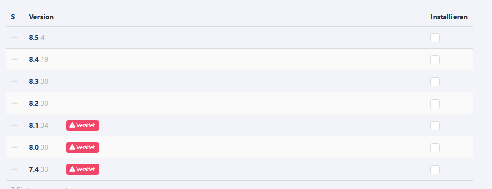

Ja
Debian 13.4 (64-bit)
KVM (Proxmox)
26.0 (Build 3624)
Interpreter lassen sich nicht installieren.
04-14-2026, 23-47-11.png (12.97 KiB) Viewed 254 times
Haken bei Installieren setzen und Speichern drücken

BleckHall wrote: Tue 14. Apr 2026, 23:49 Haken bei Installieren setzen und Speichern drücken
Und was passiert dann?

und was sagen die Logs: /var/log/keyhelp/cronjob/php-update.log / Systemstatus -> Protokolle -> php-update.log

Alexander wrote: Wed 15. Apr 2026, 09:44 und was sagen die Logs: /var/log/keyhelp/cronjob/php-update.log / Systemstatus -> Protokolle -> php-update.log
[2026-04-14 23:15:01] INFO | starting repo update
[2026-04-14 23:15:01] INFO | step: uninstall php versions
[2026-04-14 23:15:01] INFO | no tasks found
[2026-04-14 23:15:01] INFO | step: update php versions
[2026-04-14 23:15:01] INFO | no tasks found, everything is up to date
[2026-04-14 23:15:01] INFO | step: install new php versions
[2026-04-14 23:15:02] INFO | install version "7.4.33_20250821121301"
[2026-04-14 23:15:02] ERROR | failed to install version "7.4.33_20250821121301" (Failed to download from "https://repo.keyhelp.de/live/amd64/debian_13/php/7.4/php_7.4.33_20250821121301.tar.gz".)
[2026-04-14 23:15:02] INFO | install version "8.0.30_20250821115513"
[2026-04-14 23:15:02] ERROR | failed to install version "8.0.30_20250821115513" (Failed to download from "https://repo.keyhelp.de/live/amd64/debian_13/php/8.0/php_8.0.30_20250821115513.tar.gz".)
[2026-04-14 23:15:02] INFO | install version "8.1.34_20260126155559"
[2026-04-14 23:15:02] ERROR | failed to install version "8.1.34_20260126155559" (Failed to download from "https://repo.keyhelp.de/live/amd64/debian_13/php/8.1/php_8.1.34_20260126155559.tar.gz".)
[2026-04-14 23:15:02] INFO | install version "8.2.30_20260126153908"
[2026-04-14 23:15:02] ERROR | failed to install version "8.2.30_20260126153908" (Failed to download from "https://repo.keyhelp.de/live/amd64/debian_13/php/8.2/php_8.2.30_20260126153908.tar.gz".)
[2026-04-14 23:15:02] INFO | install version "8.3.30_20260126152206"
[2026-04-14 23:15:02] ERROR | failed to install version "8.3.30_20260126152206" (Failed to download from "https://repo.keyhelp.de/live/amd64/debian_13/php/8.3/php_8.3.30_20260126152206.tar.gz".)
[2026-04-14 23:15:02] INFO | install version "8.4.19_20260407142958"
[2026-04-14 23:15:02] ERROR | failed to install version "8.4.19_20260407142958" (Failed to download from "https://repo.keyhelp.de/live/amd64/debian_13/php/8.4/php_8.4.19_20260407142958.tar.gz".)
[2026-04-14 23:15:02] INFO | install version "8.5.4_20260407141422"
[2026-04-14 23:15:02] ERROR | failed to install version "8.5.4_20260407141422" (Failed to download from "https://repo.keyhelp.de/live/amd64/debian_13/php/8.5/php_8.5.4_20260407141422.tar.gz".)
[2026-04-14 23:16:01] INFO | starting repo update
[2026-04-14 23:16:01] INFO | step: uninstall php versions
[2026-04-14 23:16:01] INFO | no tasks found
[2026-04-14 23:16:01] INFO | step: update php versions
[2026-04-14 23:16:01] INFO | no tasks found, everything is up to date
[2026-04-14 23:16:01] INFO | step: install new php versions
[2026-04-14 23:16:02] INFO | install version "7.4.33_20250821121301"
[2026-04-14 23:16:02] ERROR | failed to install version "7.4.33_20250821121301" (Failed to download from "https://repo.keyhelp.de/live/amd64/debian_13/php/7.4/php_7.4.33_20250821121301.tar.gz".)
[2026-04-14 23:16:02] INFO | install version "8.0.30_20250821115513"
[2026-04-14 23:16:02] ERROR | failed to install version "8.0.30_20250821115513" (Failed to download from "https://repo.keyhelp.de/live/amd64/debian_13/php/8.0/php_8.0.30_20250821115513.tar.gz".)
[2026-04-14 23:16:02] INFO | install version "8.1.34_20260126155559"
[2026-04-14 23:16:02] ERROR | failed to install version "8.1.34_20260126155559" (Failed to download from "https://repo.keyhelp.de/live/amd64/debian_13/php/8.1/php_8.1.34_20260126155559.tar.gz".)
[2026-04-14 23:16:02] INFO | install version "8.2.30_20260126153908"
[2026-04-14 23:16:02] ERROR | failed to install version "8.2.30_20260126153908" (Failed to download from "https://repo.keyhelp.de/live/amd64/debian_13/php/8.2/php_8.2.30_20260126153908.tar.gz".)
[2026-04-14 23:16:02] INFO | install version "8.3.30_20260126152206"
[2026-04-14 23:16:02] ERROR | failed to install version "8.3.30_20260126152206" (Failed to download from "https://repo.keyhelp.de/live/amd64/debian_13/php/8.3/php_8.3.30_20260126152206.tar.gz".)
[2026-04-14 23:16:02] INFO | install version "8.4.19_20260407142958"
[2026-04-14 23:16:02] ERROR | failed to install version "8.4.19_20260407142958" (Failed to download from "https://repo.keyhelp.de/live/amd64/debian_13/php/8.4/php_8.4.19_20260407142958.tar.gz".)
[2026-04-14 23:16:02] INFO | install version "8.5.4_20260407141422"
[2026-04-14 23:16:02] ERROR | failed to install version "8.5.4_20260407141422" (Failed to download from "https://repo.keyhelp.de/live/amd64/debian_13/php/8.5/php_8.5.4_20260407141422.tar.gz".)
[2026-04-14 23:18:02] INFO | starting repo update
[2026-04-14 23:18:02] INFO | step: uninstall php versions
[2026-04-14 23:18:02] INFO | no tasks found
[2026-04-14 23:18:02] INFO | step: update php versions
[2026-04-14 23:18:02] INFO | no tasks found, everything is up to date
[2026-04-14 23:18:02] INFO | step: install new php versions
[2026-04-14 23:19:01] INFO | starting repo update
[2026-04-14 23:19:01] INFO | step: uninstall php versions
[2026-04-14 23:19:01] INFO | no tasks found
[2026-04-14 23:19:01] INFO | step: update php versions
[2026-04-14 23:19:01] INFO | no tasks found, everything is up to date
[2026-04-14 23:19:01] INFO | step: install new php versions
[2026-04-14 23:19:01] INFO | install version "8.2.30_20260126153908"
[2026-04-14 23:19:01] ERROR | failed to install version "8.2.30_20260126153908" (Failed to download from "https://repo.keyhelp.de/live/amd64/debian_13/php/8.2/php_8.2.30_20260126153908.tar.gz".)
[2026-04-14 23:19:01] INFO | install version "8.3.30_20260126152206"
[2026-04-14 23:19:01] ERROR | failed to install version "8.3.30_20260126152206" (Failed to download from "https://repo.keyhelp.de/live/amd64/debian_13/php/8.3/php_8.3.30_20260126152206.tar.gz".)
[2026-04-14 23:19:01] INFO | install version "8.4.19_20260407142958"
[2026-04-14 23:19:01] ERROR | failed to install version "8.4.19_20260407142958" (Failed to download from "https://repo.keyhelp.de/live/amd64/debian_13/php/8.4/php_8.4.19_20260407142958.tar.gz".)
[2026-04-14 23:19:01] INFO | install version "8.5.4_20260407141422"
[2026-04-14 23:19:01] ERROR | failed to install version "8.5.4_20260407141422" (Failed to download from "https://repo.keyhelp.de/live/amd64/debian_13/php/8.5/php_8.5.4_20260407141422.tar.gz".)
[2026-04-14 23:27:01] INFO | starting repo update
[2026-04-14 23:27:01] INFO | step: uninstall php versions
[2026-04-14 23:27:01] INFO | no tasks found
[2026-04-14 23:27:01] INFO | step: update php versions
[2026-04-14 23:27:01] INFO | no tasks found, everything is up to date
[2026-04-14 23:27:01] INFO | step: install new php versions
[2026-04-14 23:27:01] INFO | install version "7.4.33_20250821121301"
[2026-04-14 23:27:01] ERROR | failed to install version "7.4.33_20250821121301" (Failed to download from "https://repo.keyhelp.de/live/amd64/debian_13/php/7.4/php_7.4.33_20250821121301.tar.gz".)
[2026-04-14 23:27:01] INFO | install version "8.0.30_20250821115513"
[2026-04-14 23:27:01] ERROR | failed to install version "8.0.30_20250821115513" (Failed to download from "https://repo.keyhelp.de/live/amd64/debian_13/php/8.0/php_8.0.30_20250821115513.tar.gz".)
[2026-04-14 23:27:01] INFO | install version "8.1.34_20260126155559"
[2026-04-14 23:27:01] ERROR | failed to install version "8.1.34_20260126155559" (Failed to download from "https://repo.keyhelp.de/live/amd64/debian_13/php/8.1/php_8.1.34_20260126155559.tar.gz".)
[2026-04-14 23:27:01] INFO | install version "8.2.30_20260126153908"
[2026-04-14 23:27:01] ERROR | failed to install version "8.2.30_20260126153908" (Failed to download from "https://repo.keyhelp.de/live/amd64/debian_13/php/8.2/php_8.2.30_20260126153908.tar.gz".)
[2026-04-14 23:27:01] INFO | install version "8.3.30_20260126152206"
[2026-04-14 23:27:01] ERROR | failed to install version "8.3.30_20260126152206" (Failed to download from "https://repo.keyhelp.de/live/amd64/debian_13/php/8.3/php_8.3.30_20260126152206.tar.gz".)
[2026-04-14 23:27:01] INFO | install version "8.4.19_20260407142958"
[2026-04-14 23:27:01] ERROR | failed to install version "8.4.19_20260407142958" (Failed to download from "https://repo.keyhelp.de/live/amd64/debian_13/php/8.4/php_8.4.19_20260407142958.tar.gz".)
[2026-04-14 23:27:01] INFO | install version "8.5.4_20260407141422"
[2026-04-14 23:27:01] ERROR | failed to install version "8.5.4_20260407141422" (Failed to download from "https://repo.keyhelp.de/live/amd64/debian_13/php/8.5/php_8.5.4_20260407141422.tar.gz".)
[2026-04-14 23:40:01] INFO | starting repo update
[2026-04-14 23:40:01] INFO | step: uninstall php versions
[2026-04-14 23:40:01] INFO | no tasks found
[2026-04-14 23:40:01] INFO | step: update php versions
[2026-04-14 23:40:01] INFO | no tasks found, everything is up to date
[2026-04-14 23:40:01] INFO | step: install new php versions
[2026-04-14 23:40:01] INFO | install version "8.2.30_20260126153908"
[2026-04-14 23:40:01] ERROR | failed to install version "8.2.30_20260126153908" (Failed to download from "https://repo.keyhelp.de/live/amd64/debian_13/php/8.2/php_8.2.30_20260126153908.tar.gz".)
[2026-04-14 23:40:01] INFO | install version "8.3.30_20260126152206"
[2026-04-14 23:40:01] ERROR | failed to install version "8.3.30_20260126152206" (Failed to download from "https://repo.keyhelp.de/live/amd64/debian_13/php/8.3/php_8.3.30_20260126152206.tar.gz".)
[2026-04-14 23:40:01] INFO | install version "8.4.19_20260407142958"
[2026-04-14 23:40:01] ERROR | failed to install version "8.4.19_20260407142958" (Failed to download from "https://repo.keyhelp.de/live/amd64/debian_13/php/8.4/php_8.4.19_20260407142958.tar.gz".)
