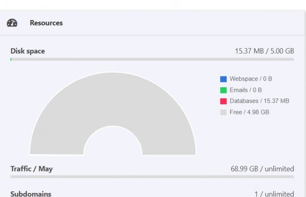

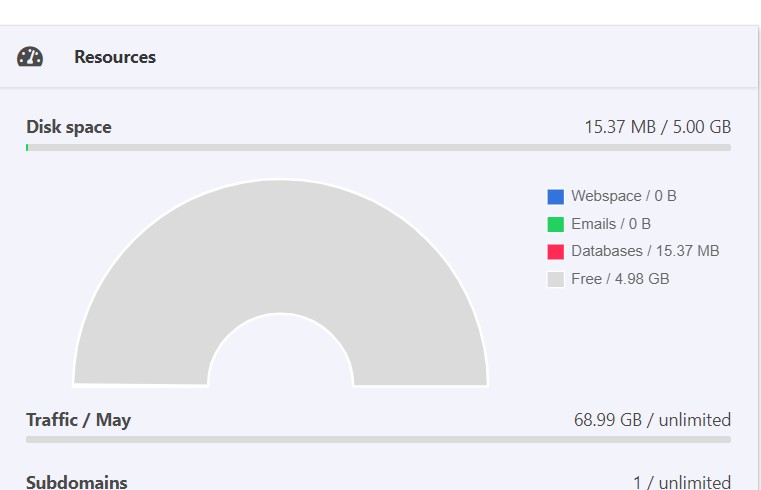

one of the users on the server is a site we run internally. Now, I know that the site has a lot of content, at least a gigabye of content. However, it is not showing up (the used space). As you can see in the attachemnt, the webspace says 0, but as you can see, the websitehas generated almost 70 GB of traffic.
And this is not limited to this site/users, no. Webspace is not being calculated on ANY user account. Webmail and database space is, not not webspace....help?

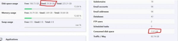

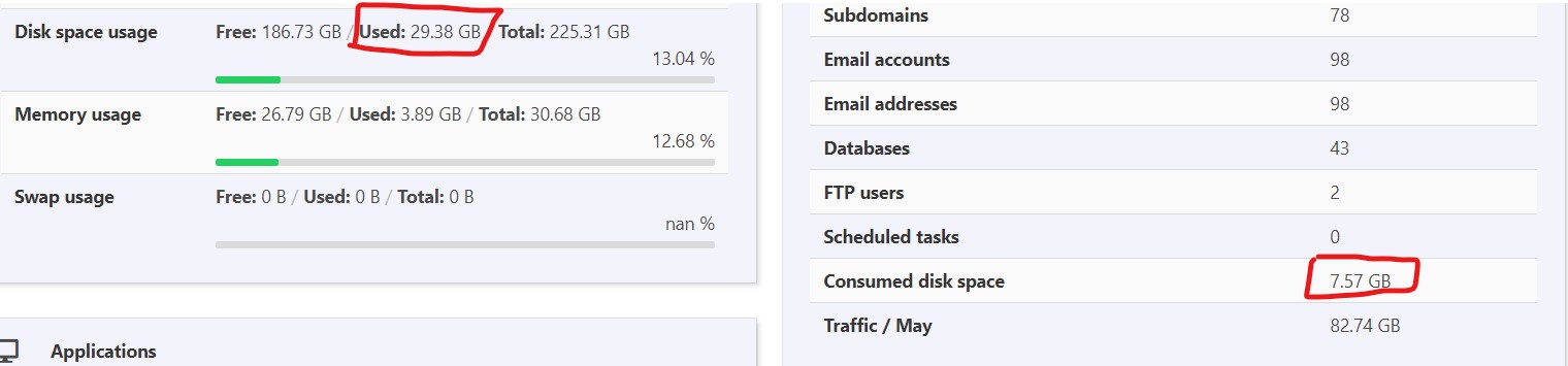

I calculcated all of the user space of all users, and it totals to aprox 7.5 GB. But in the dashboard, it says almost 30 GB used, while on the right of that, it says 7.57 of consumed disk space...

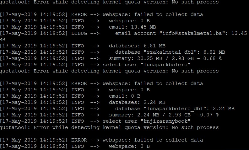

Did that. Nothing changed. In the console, it says (for every user)
quotatool: Error while detecting kernel quota version: No such process
And it says it failed to collect webspace data

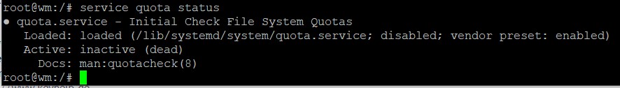

Quota is running?
service quota status
Can you please post something about your system specs. OS, virtualization (if any) and so on.

Alexander wrote: Wed 22. May 2019, 15:54 Quota is running?

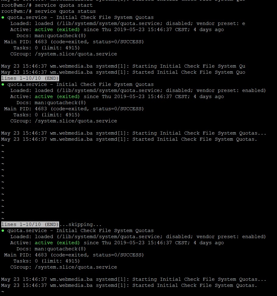

After running that command, I get that, posted in the attachment.
The server is running Ubuntu 18.04.2 LTS. The server has 32GB of RAM, 240 GB storage (no virtualization, just one partition/drive), 32 GB of RAM, and 8 vCPUs.

I did try that, however, still no success. I am still getting the same error, ERROR --> webspace: failed to collect data, for every user. I have ran the command you suggested, and then checked the status again. Here is what it shows (attachment).
I also manually started the webspace checking service on keyhelp, but with no luck.
