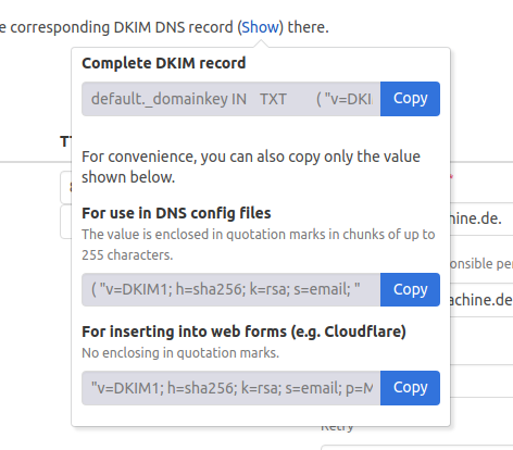

after several hours :shock: I found them .... also you have to remove the quotes in the key itself
just in case picture: https://i.imgur.com/mj1heoX.png

Yes that dkim entry isnt listed among the other dns zone and can be overlooked. The formatting also had spaces that might break the code when copy pasted.

Thanks for the input. I have now added a note, where to find the DKIM value right after the record with the value <DKIM_RECORD_VALUE>.
Additionally i have made it easier to get the value of the DKIM record, allowing you to copy only the value with and without quotes.

Hi, is this suppose to be like this in some future update ? I still (installed yesterday) see this like this:

Yes, it is part of the upcoming KeyHelp 20.1 update.
Scheduled release date is 18th May.
