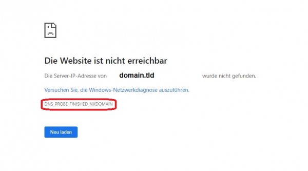

thanks for your fast answer. There is the FQDN included - but, when i go to open it - i get following error:
It seems there is some DNS problem - see Screenshot

Yes, it sounds like a problem with DNS.
Have you set the correct A-/AAAA-Resource Record for your hostname (it also the panel subdomain)?

Ok - my Hoster resolved the issue - incorrect DNS Record! :-(
