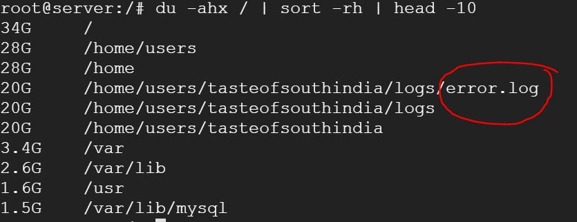

Hi hexacube, I strongly suggest reading logs, as the problem will appear there. As Alexander also suggested, it would be helpful to see some log entries, especially error.log/s and syslog here. For a log to grow that big, it is getting written to constantly, probably with obvious errors.
You could also check for what is consuming the disk. This command will output the top 10:
du -ahx / | sort -rh | head -10

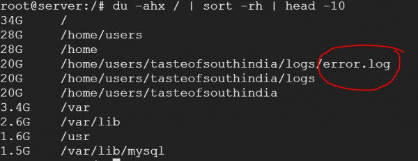

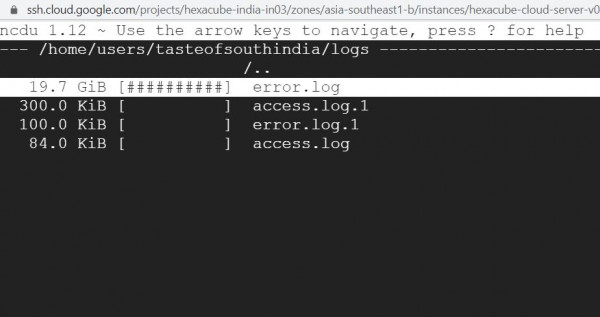

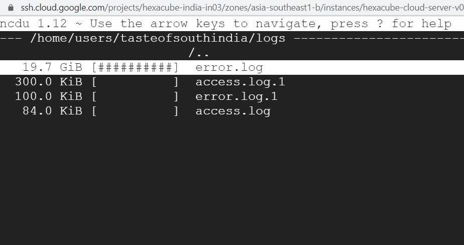

The issue has been spotted. One of the domain is undergoing brute force attack. The log file size is growing enormous. Now the size of error.log file is 19.7GB. It is a WordPress website with word fence enabled.
Even though I have enabled under attack mode in cloud flare dns, the site is still receiving bruteforce attack. Now I need to find someway to protect the website from bruteforce attacks. Screenshot attached for reference.
Is there any way to limit log file size? Help needed. Thank You.

Output of
suggested by george is giving the same output. Screenshot attached.
Posts: 3481
Re: Serious Bugs on Usage & Logs
You could write a little root cronjob an reset the error.log every X minutes.

have you checked the content of the "error.log". It should not even raise that large and errors appearing there should become resolved.
If the error.log does increase due the effect of the incomming bruteforce attack, you could temporary disable the error logging at all for this vhost.
ErrorLog /dev/null
