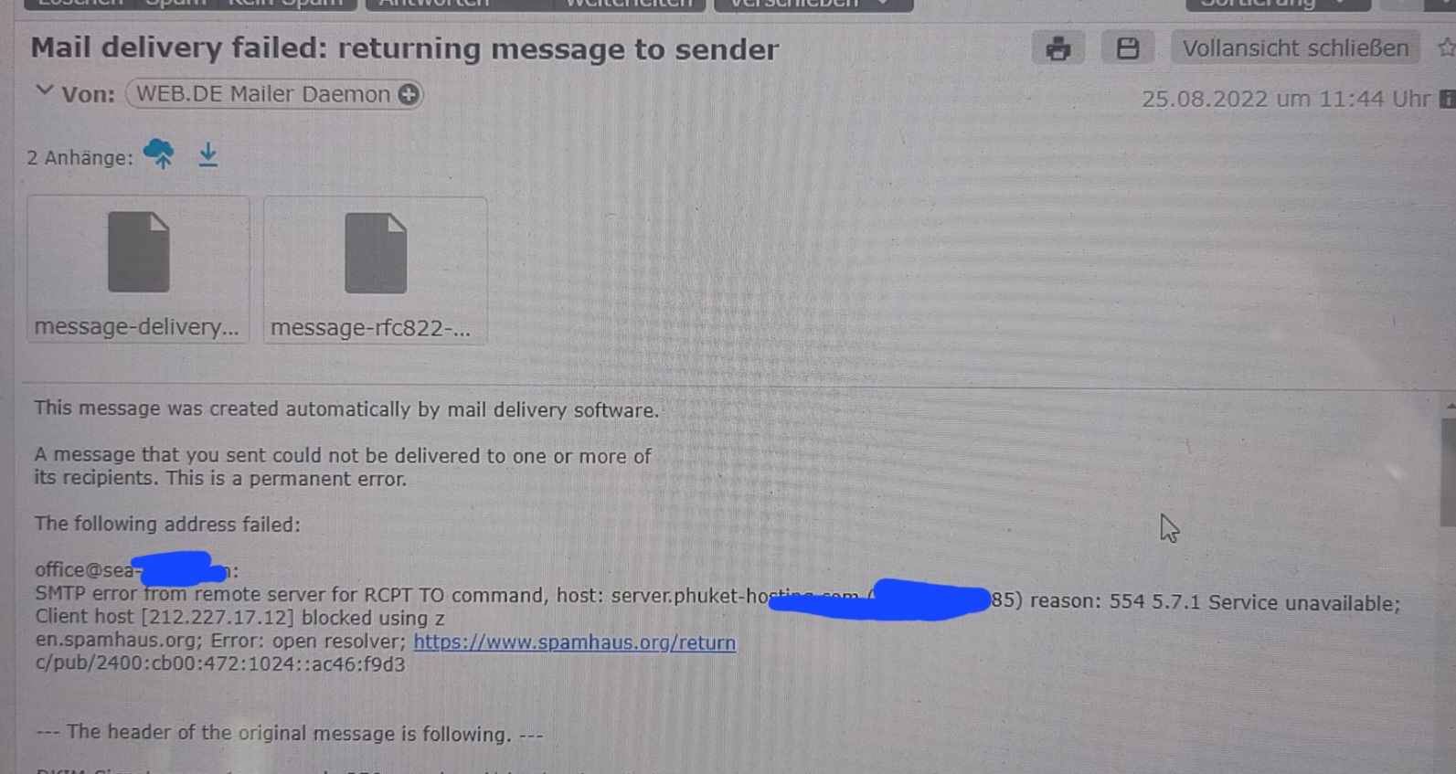

Posts: 316
Re: E-Mails werden geblockt obwohl in Whitelist vorhanden
Post by Fezzi »
Same here, never had problems with zen... but in the past days several clients complained... it started with cbl. and goes on now with zen.
Only Screenshots as the senders cant get through to the receiver...
The mail delivery failure is clear.... see attachments
Posts: 316
Post by Fezzi »
As addition... all sender Ips I have knowledge of are listet not only on spamhaus... as well according to KeyWeb technicians
