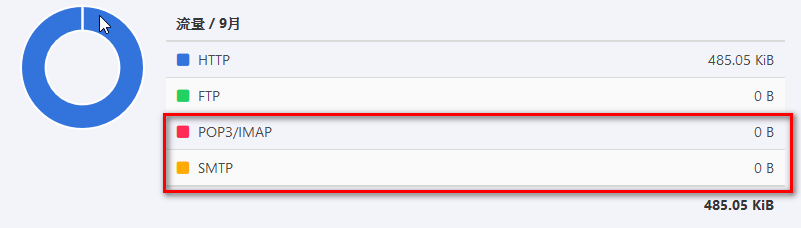

I has build new keyhelp server and just use mail server service.

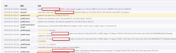

I has see user send mail and received mail.But the keyhelp panel traffic statistics always show zero.
I has see mail log.
How to fix it?

But I want know why no mail traffic.I has see incoming mail and outgoing mail.But it's always show zero.

I has manual run update statistics.But it's show zero.
