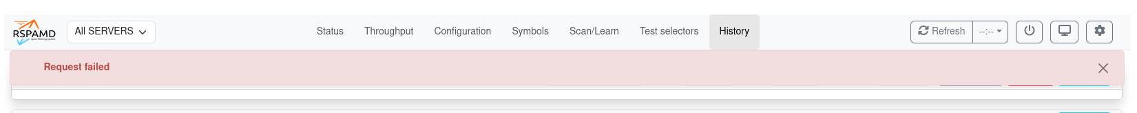

Im Panel Systemstatus -> Rspam Oberfläche in Hostory kommen nur Fehler:
26.12.2025, 10:17:53 normal 3062788 lua rro6fk cannot get ANNs list from redis: NOAUTH Authentication required.
