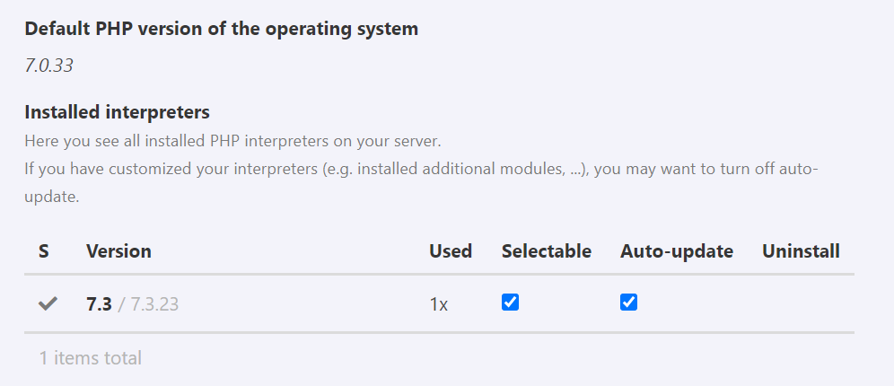

You can install older PHP versions here:
Admin area -> Configuration -> PHP interpreters
Afterwards, assign the PHP version to the corresponding domain via the domain settings.

How do you uninstall. There is no checkbox for that column?
Posts: 3643
Re: Yetishare on Keyhelp
You can't uninstall a version which is in use.

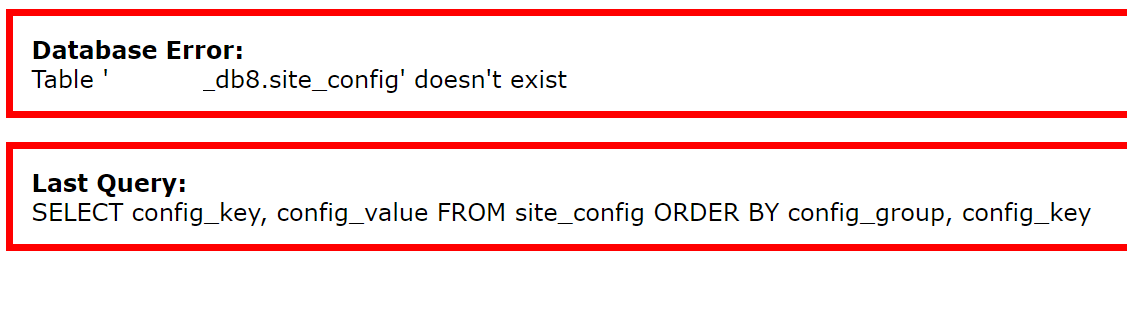

Now it does not show http 500 error
It now shows attached. That DB exist and I did import the .sql it said I should
Posts: 1904
check the tables in PHPmyadmin.
If they do not extist, something wrent wrong during the import of the database or you imported a wrong dump

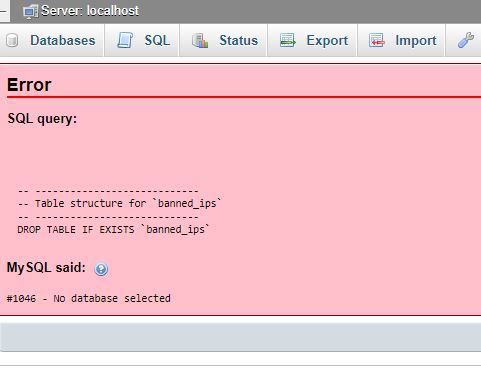

I just follow this
https://github.com/mfscripts/YetiShare- ... LATION.txt
But I get these error
Posts: 3643
As it says in the error message.
No database selected
First select a database on the left menu and then import the data.
You probably tried to import from top level of your MariaDB server.
But on top level no database is selected so far.

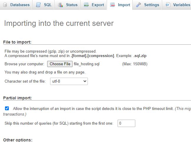

prune
Posts: 87
Joined: Thu 14. Nov 2019, 11:22
Post by prune »

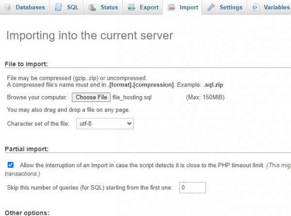

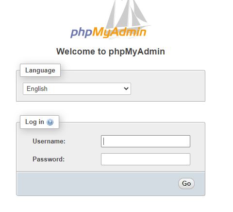

I now selected a db on the left before clicking the import tab. But after I import the sql, I just get the phpmyadmin login page :/

Post by prune »
Yes import finally worked. I just had to re-login manually after I get that login page
