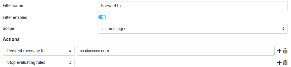

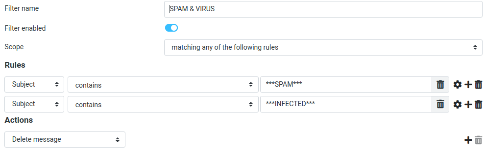

A forwarding is a forwarding and will not be filtered as far as I know.
But it works fine if you make a real mail account (min. size) and set up filter rules in it.... see attached screenshots!
Hope that helps
