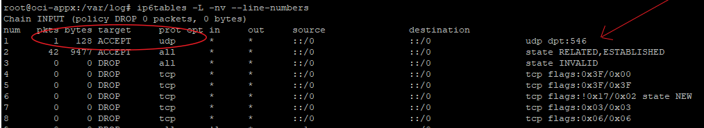

please check, if the packet-counter of the firewall counts up blocked packets after enabling the rules.
You can also add a logging statement there to find the exact cause.
ip6tables -L -nv --line-numbers
-j LOG --log-prefix 'rule-X'

After rigourous testings we finally find the Culprit! that is per this article from Huawei, IP6Tables should not block port 546 on client side (Server use 547).
  • DHCPv6 clients only process DHCPv6 packets with UDP port number 546.
  • DHCPv6 servers and relay agents only process DHCPv6 packets with UDP port number 547.
We put this on Ip6Tables as :
/usr/sbin/ip6tables  -I INPUT -p udp --dport 546 -j ACCEPT
The result :
Port 546 should be open for IPv6 to work
It is been more than 3 hours without losing IP both on AWS Cloud and Oracle Cloud!

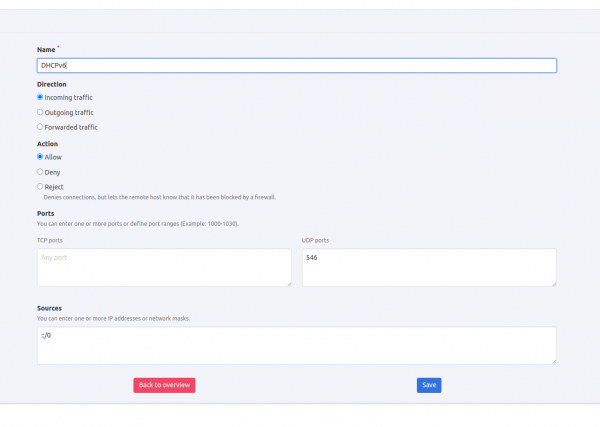

You can - and I highly encourage to do so - add this also via the KeyHelp firewall UI.
This way the firewall rules will survive a reboot and you do not have to take care of this.
With KeyHelp 21.2 | With the current KeyHelp version, one can not put a ".../0" net mask in the sources input field.
But one could simply put the the port in the UDP input field. This will result having this port open for both IPv4 and IPv6.
With KeyHelp 21.3 | For the upcoming KeyHelp version, i have updated the form validation, then you will be able to put "::/0" into the sources and this will result in the rule only being put into the IPv6 table.
Which will result in the following rules for IPv6:
