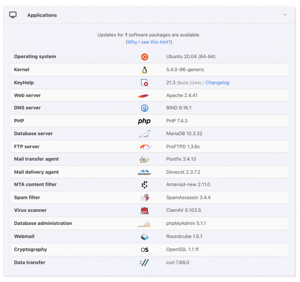

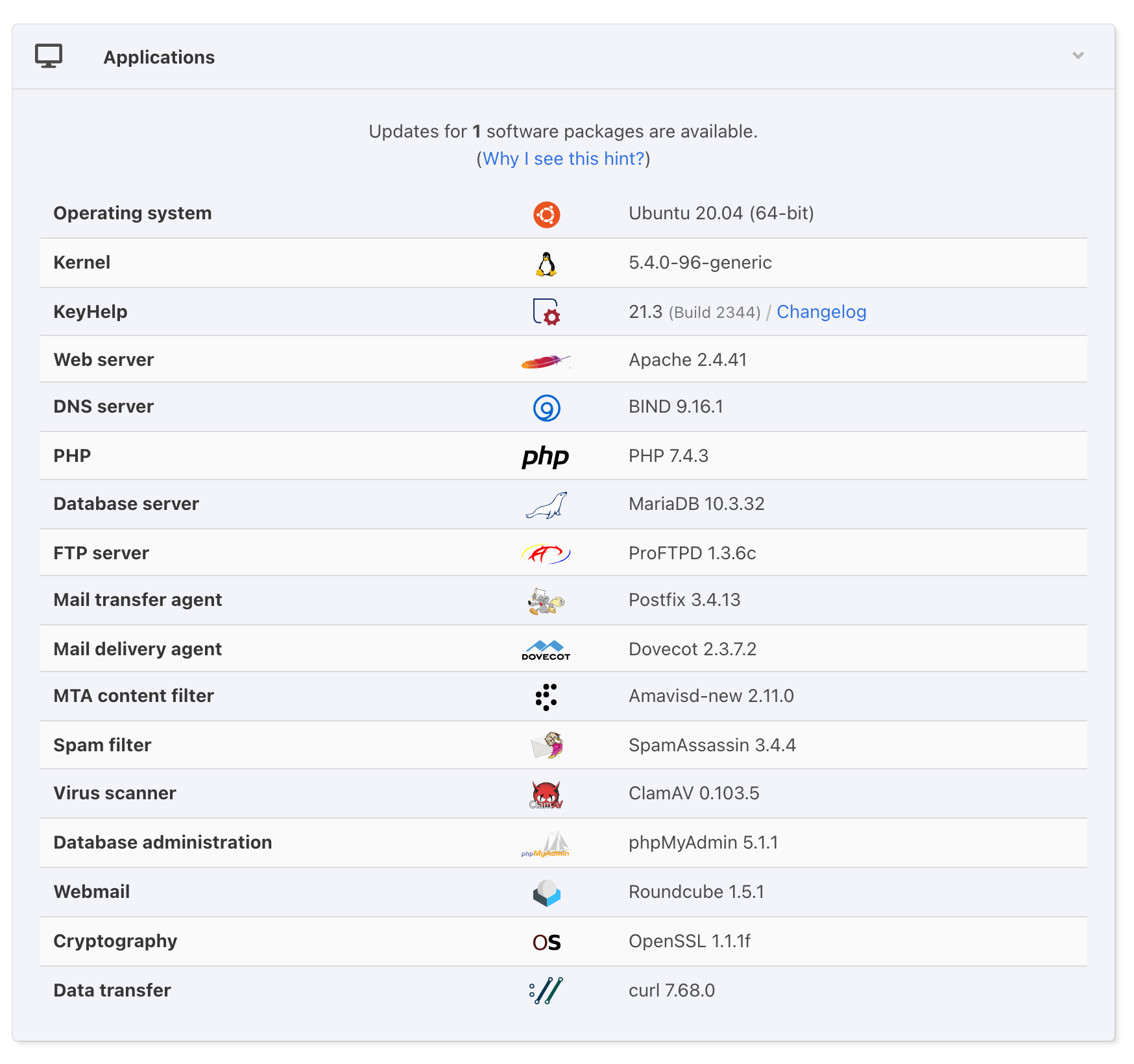

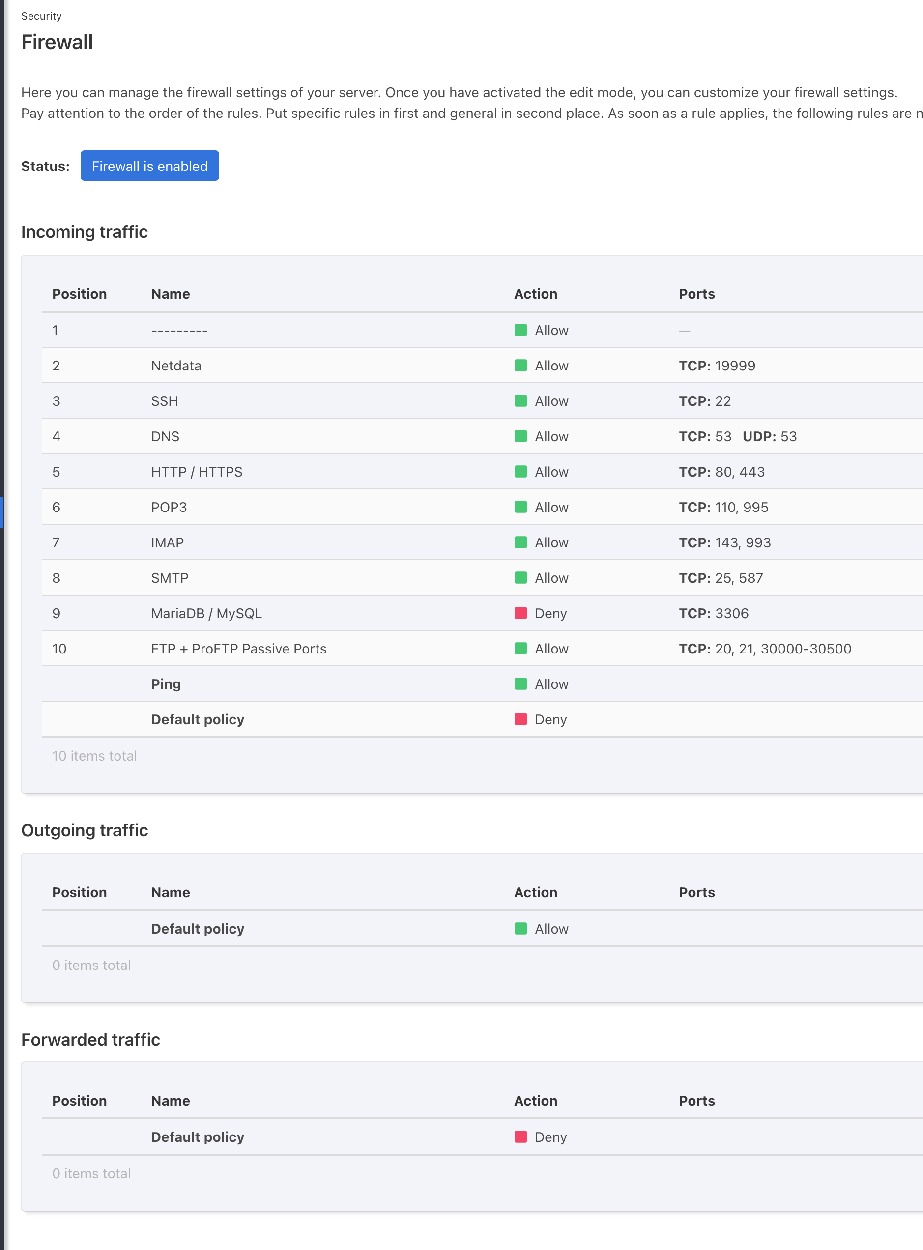

I can't see to make FTPS to work.
I have tried Explicit Mode and different FTP clients without success.
syslog doesn't have anything that can help.
Is there anything I can try to pinpoint the issue?
Thanks
Posts: 4707
Re: FTPS not working - unable to accept TLS connection: system call error: [0] Success  [SOLVED]
Please attach a more detailed log from your FileZille (or other FTP client). That way you could see which TLS version is used to establish the connection.
However, I think this is more of a problem with proFTPD (the FTP server software running on the KeyHelp machine) and most likely has nothing to do with the way KeyHelp sets up this FTP server.
