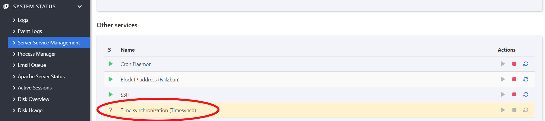

Ubuntu 22.04
Amazon/AWS
23 - Latest
Clean install Ubuntu LTS 22 before installing latest Keyhelp will install Chrony as Time Sync. No longer install TimeSyncd.
Expected result
Update UI of Keyhelp
Actual result
Steps to reproduce
Open https://DOMAIN/index.php?page=admin_services
Additional information
(e.g. recent changes to the server, excerpts from log files (/var/log/*, /var/log/keyhelp/php-error.log, etc.))

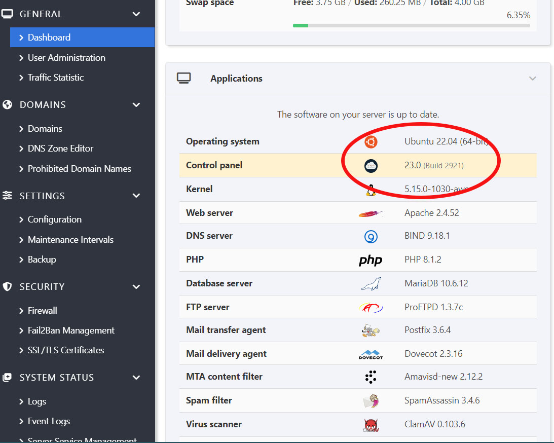

Also your KeyHelp is outdated as we are on version 23 and not 22.
You may want to update the panel first.

BasHeijermans wrote: Sun 26. Feb 2023, 15:39 https://docs.aws.amazon.com/AWSEC2/late ... -time.html
Sorry, I was wrong putting version in description. Here is my KeyHelp version :

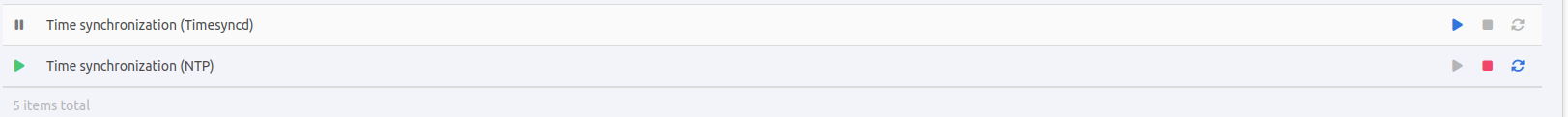

Just checked my server, I run NTPD instead of Chrony on my KeyHelp system.
You may want to switch to NTPD?
My system also doesn't contain TimeSyncd.
Schermafdruk op 2023-02-26 16-54-58.png (10.65 KiB) Viewed 39121 times
My sever shows this.
Greetings Bas.

Turns out, since Ubuntu 18, it has been defaulted and recommendec to use Chrony as TimeSync utility. Ubuntu 22 LTS also defaulted to use Chrony upon clean installation.
Source : https://ubuntu.com/blog/ubuntu-bionic-u ... figure-ntp
Whatever the choices, KeyHelp UI needs update.
Re: KeyHelp UI need Update on TimeSync section.  [SOLVED]
I would argue this, as none of my test systems ever used chrony, instead of timesyncd (or in the past ntp).
I also "enforce" timesyncd, when updating to Ubuntu 22 / Debian 11 via the OS-upgrade scripts.
However, i added Chrony to the list on the corresponding page in KeyHelp now and hide it, if it is not installed. Also timesyncd is hidden now, if it is not installed.
