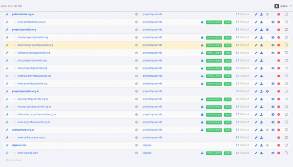

Problems after upgrade Ubuntu 20.04 -> 22.04 using KeyHelp PHP script
Post by gusarg81 »
After finished all the process, and using KeyHelp script from https://www.keyhelp.de/en/news/upgrade- ... ubuntu-22/, all domains shows as Processing State (see attachment).
So, some domais does not work ("Service Unavailable -The server is temporarily unable to service your request due to maintenance downtime or capacity problems. Please try again later.").
Any ideas? Thanks in advance.
EDIT1: also, for what I can see, there is no user domains PHP-FPM Running, only from KeyHelp:
/run/php$ ls
keyhelp_keyhelp.socket php8.1-fpm.pid
When should be something like keyhelp_proyectopuravida.socket and keyhelp_viajeres .socket ("proyectopuravida" and "viajeres" are the domain users) and there is not there.
EDIT2: also, I found this folder empty:
puravida@server:/etc/php/8.1/fpm/keyhelp_pool$ pwd
