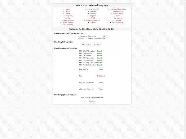

Howdy,
I want to install a script, and it asks me to have this module in php 5.6 Pear php5.6 mod required
[b]Checking required modules:[/b]
Pear Not found
Can you help me what is needed? I use keyhelp, but I can't find the problem, maybe someone knows?
Thank you!

dpkg -l|grep pear
ii pear-channels 0~20190819-1build4 all PEAR channels for various projects
ii php-pear
I tried on all PHP versions, the script is compatible with all available php versions, but none of the versions have pear installed.
Pear
Not found
php5.6 7.0 7.1 7.2 7.3 7.4 8.0 8.1 .8.2
