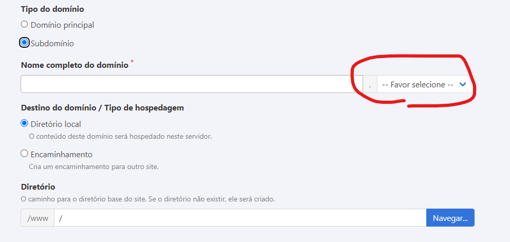

mizael
Posts: 1
Joined: Thu 17. Oct 2024, 16:40
Re: Cannot add subdomain
Post by mizael »
Alexander wrote: Tue 10. Sep 2024, 10:23 The problem is solved.
There was one client, who could not add a subdomain to one of its domains (and it resulted in a error 500).
My first guess, the IDs in the database were off, was wrong, all IDs seems to be fine.
I did not had SSH access to the server, so i "played" around in the KeyHelp UI and somehow was able to fix it, but i could not investigate the real reason behind (due to missing SSH access).
I added a subdomain for this particular client via the admin area -> that worked.
Than i deleted this domain and went to the client and tried again to add a subdomain, and now this also worked.
- Kind of strange, but so i will not be able to reproduce the problem anymore.
i was able to reproduce the error by not selecting a domain and saving anyway, resulting in server error 500
Posts: 4672
Re: Cannot add subdomain  [SOLVED]
Ahhh, nice catch, thank you very much!
A classic regression bug :). I have fixed it for the upcoming KeyHelp version.
Thank you!
