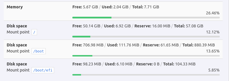

Disk space calculator doesn't calculate the disk space
Expected result
Show me the consumed disk space.
Steps to reproduce
no idea as it's not my code.
I'm ready to arrange some meeting online on my conference server if i could help and you cannot reproduce the issue;
just contact me via email, i think admins can see my email address, right?
Additional information

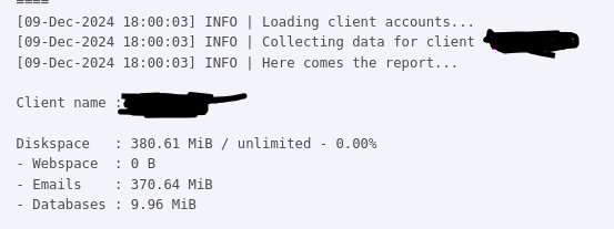

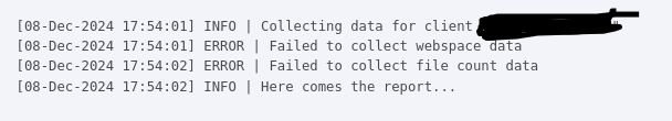

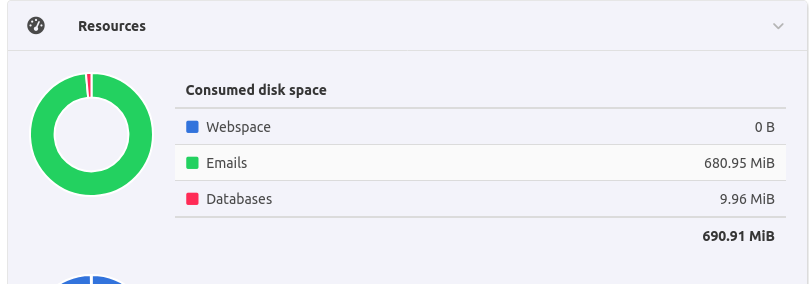

Same results in the client accounts.

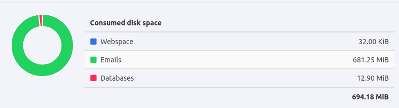

update: i wanted to update the previous post to add a note but couldn't edit the post anymore:
the admin dashboard shows now 32KB (KiB?) which is not correct.
Obviously i triggered the relative maintenance interval responsible for calculating the disk space various times, just to be sure.

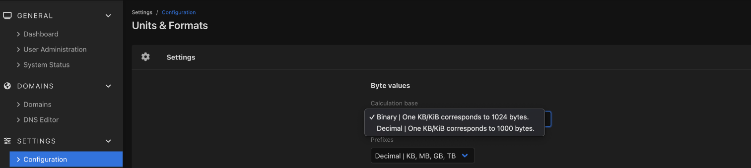

I don't have a solution for your actual problem, sorry, but:
nobody wrote: Mon 9. Dec 2024, 19:17 the admin dashboard shows now 32KB (KiB?) which is not correct.
Luckily, you can change that display behaviour like you want:
Binary, what is right, and decimal, which has nothing to do with computers. That would be a discussion for it's own, but it's nice that KeyHelp leaves you the option :-)
So if you grew up with computers in the last century, you'll want to choose binary for calculation base and decimal for prefixes, and everything looks like you expect. :-)

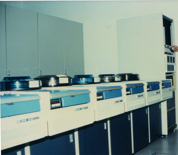

The bulges you see on the top of these machines was the place for the "hard disks":
Unfortunately lots of knowledge is getting lost from generation to generation, people aren't interested anymore in basic things.
