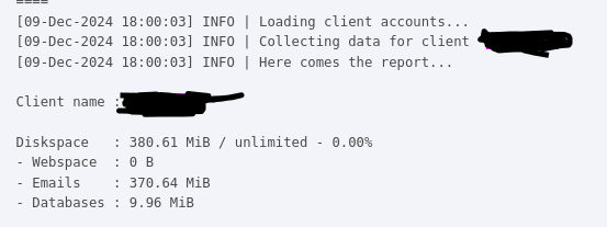

Disk space calculator doesn't calculate the disk space
Expected result
Show me the consumed disk space.
Steps to reproduce
no idea as it's not my code.
I'm ready to arrange some meeting online on my conference server if i could help and you cannot reproduce the issue;
just contact me via email, i think admins can see my email address, right?
Additional information
Same results in the client accounts.

Re: Webpace and files count calculator won't work - disk space is 0B  [SOLVED]
Posted: Mon 9. Dec 2024, 07:54
by Florian
check if the package "linux-image-extra-virtual" is installed on your VM, otherwise the quotatools will not work

Please have a look at viewtopic.php?p=50909#p50909
Posted: Mon 9. Dec 2024, 20:24
by nobody
Tobi wrote: Mon 9. Dec 2024, 19:44 Please have a look at viewtopic.php?p=50909#p50909
That did it! 1000 thanks.
