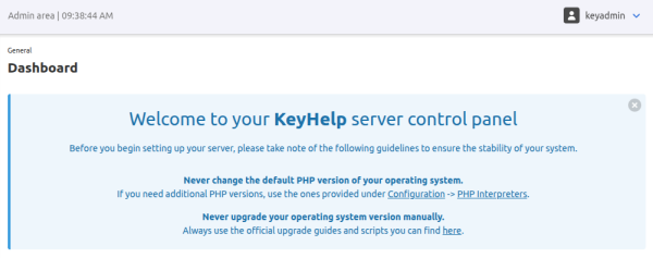

Please make sure you have read the notice when first logging into KeyHelp after installation:
"Never change the default PHP version of your operating system"
Because you have altered the default PHP version of your system, you encounter the issues you have faced. That's why there is this note in KeyHelp ;).
First, uninstall all PHP versions, which are not the default of the current operation system version. Only use the PHP version from Ubuntu sources, do not use the ones from ondrej (or others).
