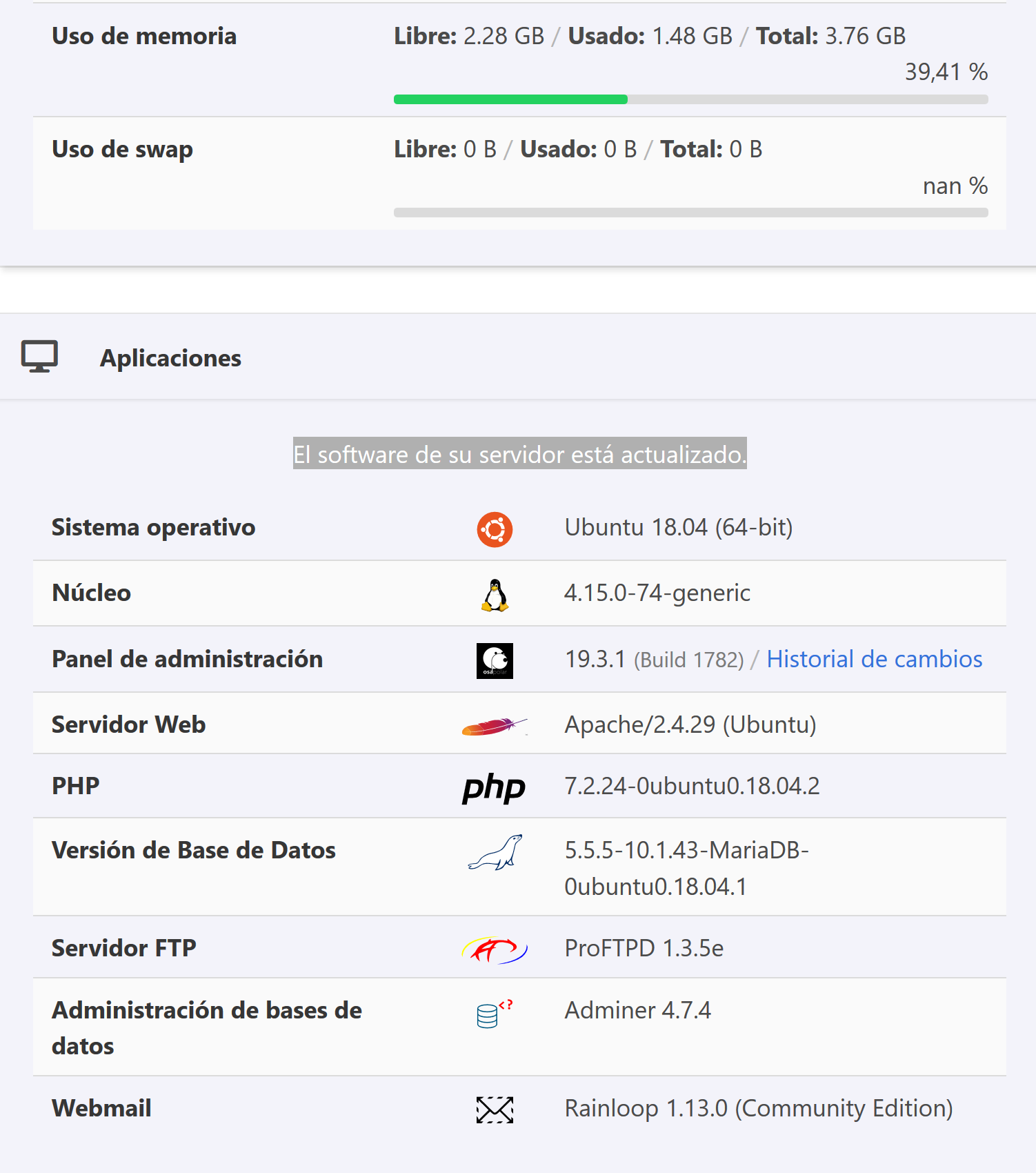

This is what the control panel says regarding both tools
Administración de bases de datos Adminer 4.7.4
Webmail Rainloop 1.13.0
And this is what I see in the terminal
~$ apt-cache policy adminer
adminer:
Installed: (none)
Candidate: 4.6.2-1
Version table:
4.6.2-1 500
rainloop returns nothing.

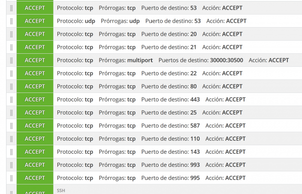

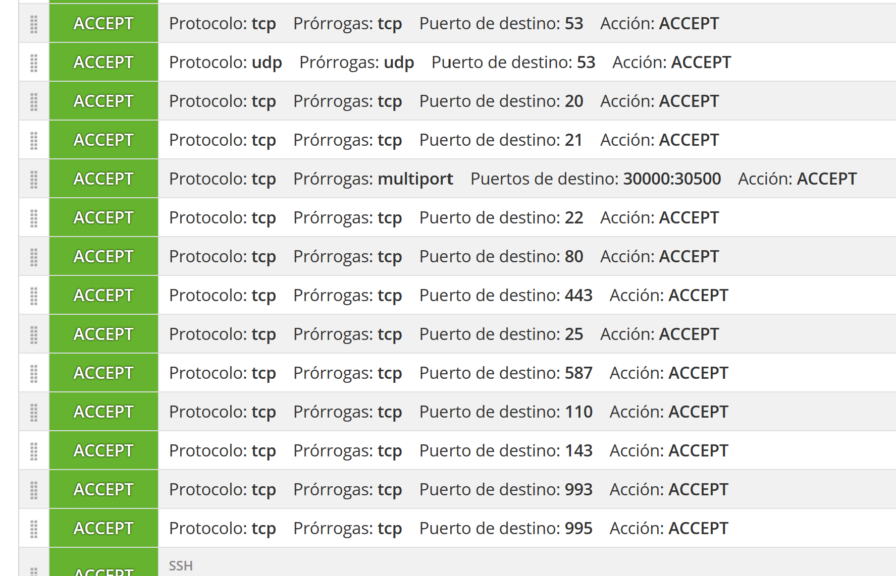

Yes, I installed the Ubuntu mirror image on Hetzner, updated packages, created a second user besides root (tried to install it using the certificate, but that went wrong and I could only access with a password) and changed ssh port before installing Keyhelp.
So I added the ssh port in Keyhelp firewall page to be able to connect via putty/bitvise and started creating the additional user I need to create the email accounts. The I tried to access the webmail and found I couldn't. And then I checked adminer and the link didn't work.

lmarcos wrote: Sun 26. Jan 2020, 13:09 And this is what I see in the terminal
adminer:
Installed: (none)
Candidate: 4.6.2-1
Version table:
4.6.2-1 500
But adminer is not showing in the www folder of the domain as it does on my other server.
