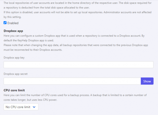

New backup management its Enabled. please check attached and time from backup start until now and still not complete. its run but very slowly.
31-29 084218.png (6.68 KiB) Viewed 30042 times
