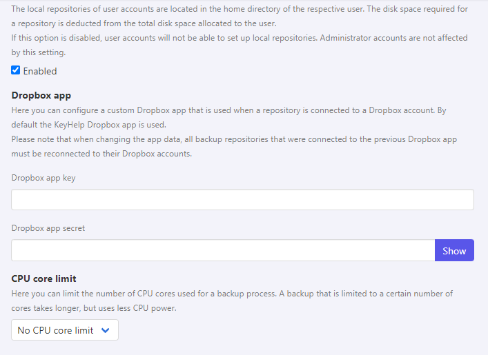

New backup management its Enabled. please check attached and time from backup start until now and still not complete. its run but very slowly.

Re: Backup take long time "Backup slowly"
So you are using the new backup management.
- Where do you upload your backup? The problem may be at the remote side.
- Since when does the repository exist? Since January 2023, all NEW repositories use a compression function that should significantly reduce the file size, which could help a potential weak remote server.
- Is the backup really still running? Do the percentage values change? Is the "restic" process still running? Perhaps it has crashed (e.g. due to a restart of the server during the backup, etc.)
Unfortunately you have not said anything about my 2 first points.
The amount of data you are going to backup is rather small, i would guess this should not last more than 10 minutes to backup in normal circumstances. Especially if it is a follow up backup run. Because of a incremental backup, this should run only 3-4 minutes with the second and following runs.
To test this: Do a local backup, to see how fast it should be.
So I guess, the problem is the backup remote storage or the internet connection between these two servers. Which seems really slow. This would be out of scope of KeyHelp.
To test this: Establish a SFTP connection between the two servers and measure the speed.
