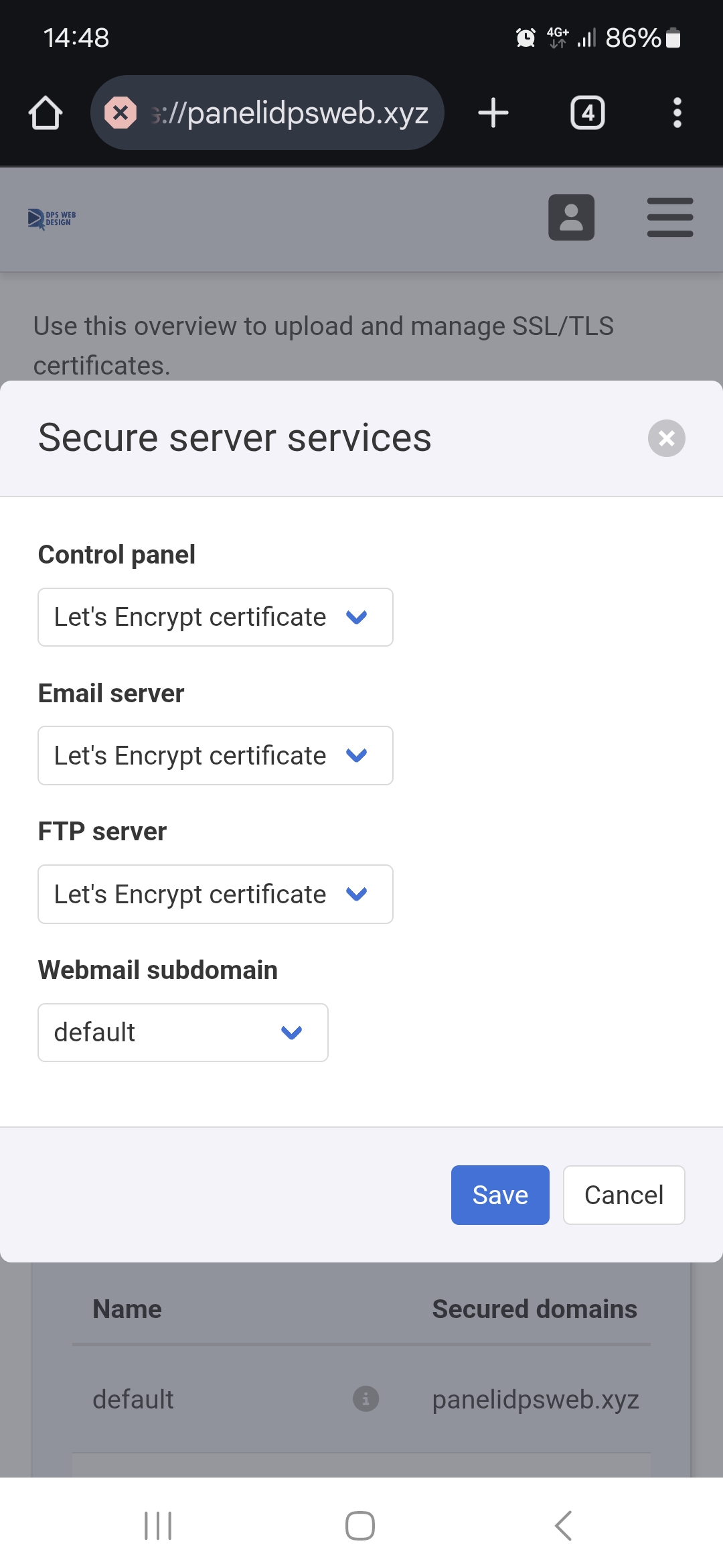

I have problem with Ssl in my panel..
Can you help my..
Panel: panelidpsweb.xyz
Posts: 1772
Re: Problem SSL/TLS Certificates
did you activate Let's Encypt for securing the panel domain under SSL certificates > securing services ?
fatontonni123
Posts: 18
Joined: Sun 29. Dec 2024, 13:53
Post by fatontonni123 »
Yes is active but dont work
Posts: 1772
switch back to default certificate, wait at least 1 minute then switch back to Let's Encrypt

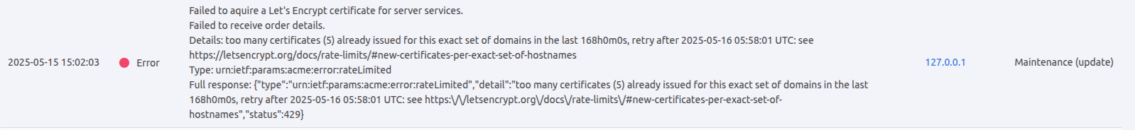

Posts: 1772
Re: Problem SSL/TLS Certificates  [SOLVED]
fatontonni123
Posts: 18
Yes this is Error But how to fixx?
Posts: 1772
one word: wait
