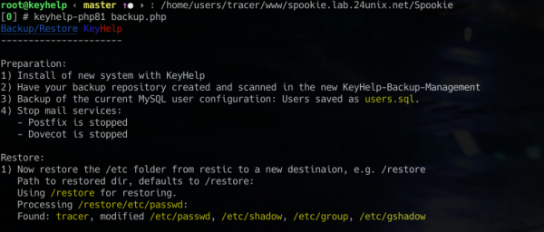

Work in Progress. That's was it already does:
It needs to be run as root (Debian) or via sudo (Ubuntu).
keyhelp-php81 backup.php

The current state of the script (most critical calls are commented, as they were tested and will be reenabled after the script is finished:
<?php

echo COLOR_YELLOW . 'Backup/Restore ' . COLOR_BLUE . 'Key' . COLOR_RED . 'Help' . PHP_EOL;
echo COLOR_WHITE . '----------------------' . PHP_EOL . PHP_EOL;
echo COLOR_DEFAULT . 'Preparation:' . PHP_EOL;
echo '1) Install of new system with KeyHelp' . PHP_EOL;
echo '2) Have your backup repository created and scanned in the new KeyHelp-Backup-Management' . PHP_EOL;
echo '3) Backup of the current MySQL user configuration: ';
runCommand(command: 'mysqldump --system=users 2>&1 > users.sql');
echo 'Users saved as ' . COLOR_YELLOW . 'users.sql' . COLOR_DEFAULT . '.' . PHP_EOL;
echo '4) Stop mail services:' . PHP_EOL;
//runCommand('systemctl stop postfix');
echo '   - Postfix is stopped' . PHP_EOL;
//runCommand('systemctl stop dovecot');
echo '   - Dovecot is stopped' . PHP_EOL . PHP_EOL;

echo '1) Now restore the /etc folder from restic to a new destinaion, e.g. /restore' . PHP_EOL;
$path = readline(prompt: "   Path to restored dir, defaults to /restore: ");
if ($path == '') {
    $path = '/restore';
echo '   Using ' . COLOR_YELLOW . $path . COLOR_DEFAULT . ' for restoring.' . PHP_EOL;
echo '   Processing ' . COLOR_YELLOW . $path . ETC_PASSWD . COLOR_DEFAULT . ':' . PHP_EOL;
$etcPasswd = file(filename: $path . ETC_PASSWD);
$etcShadow = file(filename: $path . ETC_SHADOW);
$etcGroup = file(filename: $path . ETC_GROUP);
$etcGShadow = file(filename: $path . ETC_GSHADOW);
$users = preg_grep(pattern: '/home\/users/', array: $etcPasswd);
foreach ($users as $user) {
    [$username, $password, $uid, $gid, $gecos, $home, $shell] = explode(':', $user);
    echo '   Found: ' . COLOR_YELLOW . $username . COLOR_DEFAULT;
    //file_put_contents(filename: ETC_PASSWD, data: $user, flags: FILE_APPEND);
    echo ', modified ' . COLOR_YELLOW . ETC_PASSWD;
    $shadow = preg_grep(pattern: "/^$username:/", array: $etcShadow);
    //file_put_contents(filename: ETC_SHADOW, data: $shadow, flags: FILE_APPEND);
    echo COLOR_DEFAULT . ', ' . COLOR_YELLOW . ETC_SHADOW;
    $group = preg_grep(pattern: "/^$username:/", array: $etcGroup);
    //file_put_contents(filename: ETC_GROUP, data: $group, flags: FILE_APPEND);
    echo COLOR_DEFAULT . ', ' . COLOR_YELLOW . ETC_GROUP;
    $gshadow = preg_grep(pattern: "/^$username:/", array: $etcGShadow);
    //file_put_contents(filename: ETC_GSHADOW, data: $gshadow, flags: FILE_APPEND);
    echo COLOR_DEFAULT . ', ' . COLOR_YELLOW . ETC_GSHADOW . COLOR_DEFAULT . PHP_EOL;
// handle KeyHelp groups

root@server:~# php copia.php
Backup/Restore KeyHelp
Preparation:
3) Backup of the current MySQL user configuration: Users saved as users.sql.
Restore:
Path to restored dir, defaults to /restore: 1
Using 1 for restoring.
Processing 1/etc/passwd:
PHP Warning: file(1/etc/passwd): Failed to open stream: No such file or directory in /root/copia.php on line 42
PHP Warning: file(1/etc/shadow): Failed to open stream: No such file or directory in /root/copia.php on line 43
PHP Warning: file(1/etc/group): Failed to open stream: No such file or directory in /root/copia.php on line 44
PHP Warning: file(1/etc/gshadow): Failed to open stream: No such file or directory in /root/copia.php on line 45
PHP Fatal error: Uncaught TypeError: preg_grep(): Argument #2 ($array) must be of type array, bool given in /root/copia.php:47
Stack trace:
#0 /root/copia.php(47): preg_grep()
#1 {main}
thrown in /root/copia.php on line 47
root@server:~# ^C

PuntonetSvb wrote: Mon 30. Jan 2023, 15:47 1) Now restore the /etc folder from restic to a new destinaion, e.g. /restore
You must enter a path, I guess "1" is neither a path nor does it contain the restored data, right?

Preparation:
Restore:
Using /restore for restoring.
Processing /restore/etc/passwd:
I make restore dir and other files manually, and now i see it when run script
